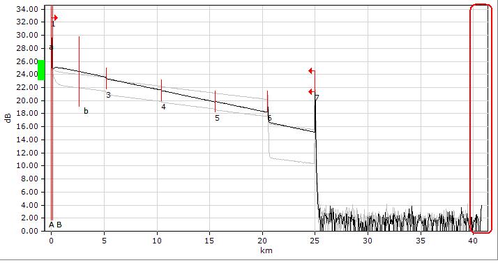

Post by Pradip » Fri Jul 10, 2009 5:51 pm
hi
please see below image

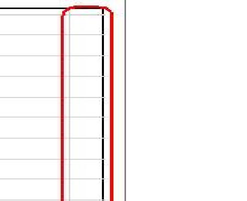

for more clear picture please see this images
the horizontal grid lines (which are gray in color) are overlapping on the axes on the right side(black in color).
in 400% zoom the lines are more cleares and it looks like the right side axis is cutting.
please give us any solution so that we can resolve this defect.
thank in advance.

i had tried your code to resolve this problem, at first it looks ok, but if we zoom to 400 there are still small lines shows on the vertical right axes, which was not accepted at our end.
