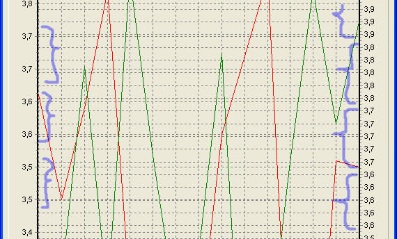

But I found a "half" solution in the meantime. It helps alot if I set the minimum distance (in %) at 100% for the axis label.
But this is only one step and there are other problems. See the following picture:
I set the value format for both axis to #.##0,0 which is a common format in our application. If you have a big axis you will see double entries like on the picture.
This is really confusing for users.
So how can I disable the double values? It would be great if only the first one would be shown. So if yo have values like this:

Post by Narcís » Mon Mar 03, 2008 11:52 am
Hi Dominik,
You could try setting specific Increment depending on what's displayed on your chart. In the image you sent you could try setting Increment to 0.1 to remove the labels you mentioned.
