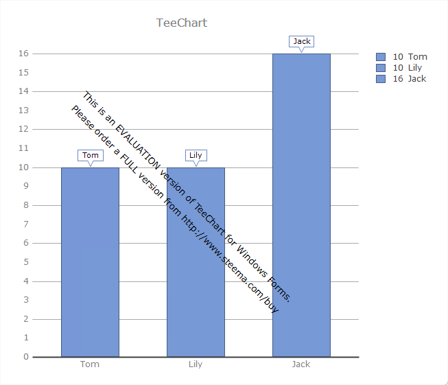

Re: Add function use?
Post by Christopher » Tue Jan 17, 2023 11:19 am
yes, you can use the IList overload of the Add function to do this, e.g.
      var bar = new Bar(tChart1.Chart);
      var list = new List<Student>
        new Student { Age = 10, Name = "Tom" },
        new Student { Age = 10, Name = "Lily" },
        new Student { Age = 16, Name = "Jack" }
      bar.YValues.DataMember = "Age";
      bar.LabelMember = "Name";
      bar.Add(list as IList);
Which gives me:

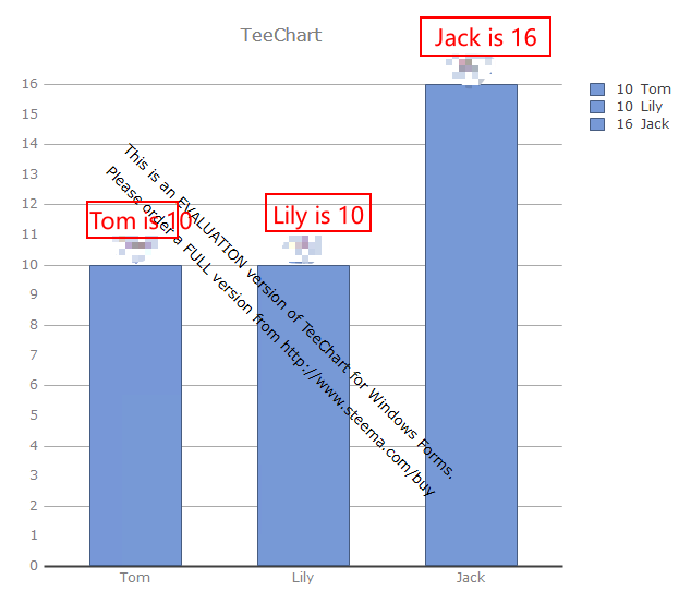

But i hope the Mark can custom.
e.g. set the format is
$"{Name} is {Age}"
so the chart show like :
And I hope the mouse hover the Specified bar ,then the Mark will show like above.When the mouse leave the Specified bar ,the Mark will hide.
Post by Christopher » Thu Jan 19, 2023 9:20 am
yes, you can achieve this with code such as the following:
      var markstip = new MarksTip(tChart1.Chart);
      void Bar_GetSeriesMark(Series Series, GetSeriesMarkEventArgs e)
        e.MarkText = $"{list[e.ValueIndex].Name} is {list[e.ValueIndex].Age}";
      bar.GetSeriesMark += Bar_GetSeriesMark;
