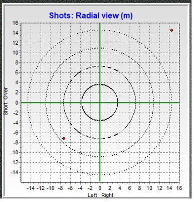

Hi I am quite a newbie with charting end definitely with TeeChart. I need to create a chart as per the included image but have no idea how to approach it. I have investigated XY plots as well as polar plots but am not able to create this.
Some guidance will be appreciated

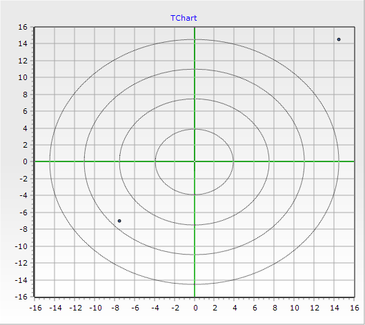

Here a simple example using ColorLineTools for the green lines and manually drawing the circles at OnBeforeDrawSeries event:
uses Series, VCLTee.TeeTools;
procedure TForm1.Chart1BeforeDrawSeries(Sender: TObject);
const radius: array of Double=[3.9, 7.5, 11, 14.5];
var i, x, y, w, h: Integer;
  for i:=0 to High(radius) do
    with Chart1.Canvas do
      Brush.Clear;
      Pen.Color:=clBlack;
      Pen.Width:=1;
      Pen.Style:=psDot;
      with Chart1.Axes do
        Ellipse(Bottom.CalcPosValue(radius[i]), Left.CalcPosValue(radius[i]),
                Bottom.CalcPosValue(-radius[i]), Left.CalcPosValue(-radius[i]));
  Chart1.View3D:=False;
  Chart1.Legend.Hide;
  Chart1.Axes.Left.SetMinMax(-16,16);
  Chart1.Axes.Bottom.SetMinMax(-16,16);
  with TColorLineTool(Chart1.Tools.Add(TColorLineTool)) do
    Axis:=Chart1.Axes.Left;
    Pen.Color:=clGreen;
    Pen.Width:=2;
    Value:=0;
    Axis:=Chart1.Axes.Bottom;
    Pen.Color:=clGreen;
    Pen.Width:=2;
    Value:=0;
  with TPointSeries(Chart1.AddSeries(TPointSeries)) do
    Pointer.Size:=2;
    Pointer.Style:=psCircle;
    AddXY(-7.5,-7);
    AddXY(14.5, 14.5);
