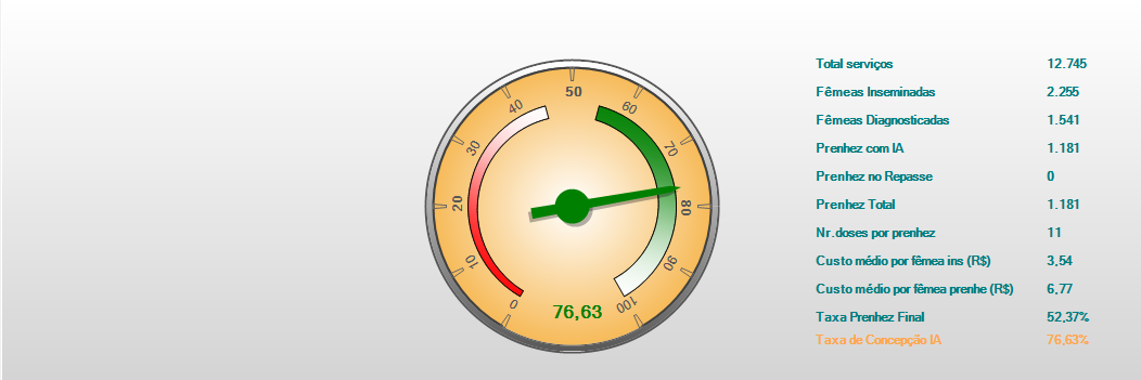

Good morning,
I am working on a circular gauge with an annotation.
I want the chart left aligned to use the rest of area to put some annotations.
Attached my TChart area print.
What I mean is to put the gauge at left, leaving the whole area of chart freed for notes.
Is it possible to left align the chart?

Post by Christopher » Fri Feb 22, 2019 7:57 am
Hello!
Sofia Moraes wrote:
Thu Feb 21, 2019 11:31 am
Yes, yes it is. You will be able to use the GetAxesChartRect event to define the rectangle in which you want to draw the CircularGauge series e.g.:
            tChart1.Series.Add(typeof(CircularGauge)).FillSampleValues();
            tChart1.GetAxesChartRect += TChart1_GetAxesChartRect;
        private void TChart1_GetAxesChartRect(object sender, Steema.TeeChart.GetAxesChartRectEventArgs e)
            var rect = e.AxesChartRect;
            rect.Width = 200;
            rect.X = 200;
            e.AxesChartRect = rect;
