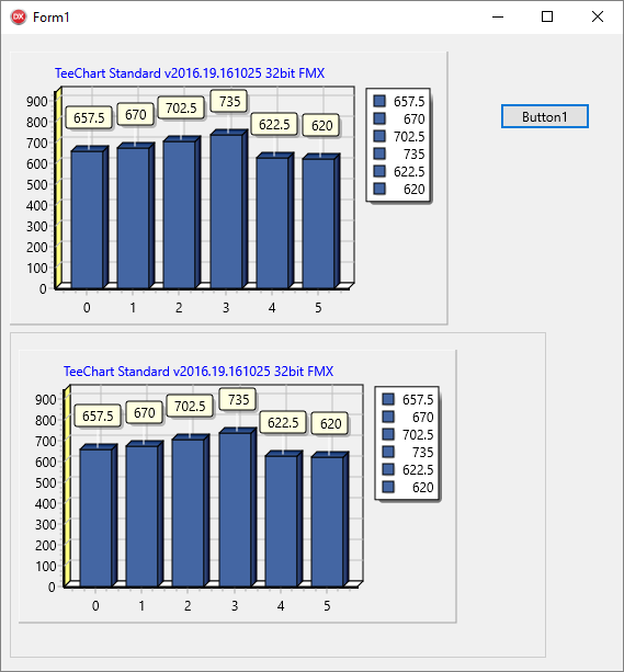

I've tried to reproduce the problem with a new simple FMX application. I've only dragged a TButton, a TPanel and two TCharts (one of the charts on the form and the second on the panel).
Here the code I tested:
uses FMXTee.Store, FMXTee.Constants, FMXTee.Series;
  Chart1.AddSeries(TBarSeries).FillSampleValues;
  RegisterTeeStandardSeries;
var tmpStream: TMemoryStream;
  tmpStream:=TMemoryStream.Create;
  SaveChartToStream(Chart1, tmpStream);
  tmpStream.Position:=0;
  LoadChartFromStream(Chart2, tmpStream);
And I got two exact charts after pressing the button:
