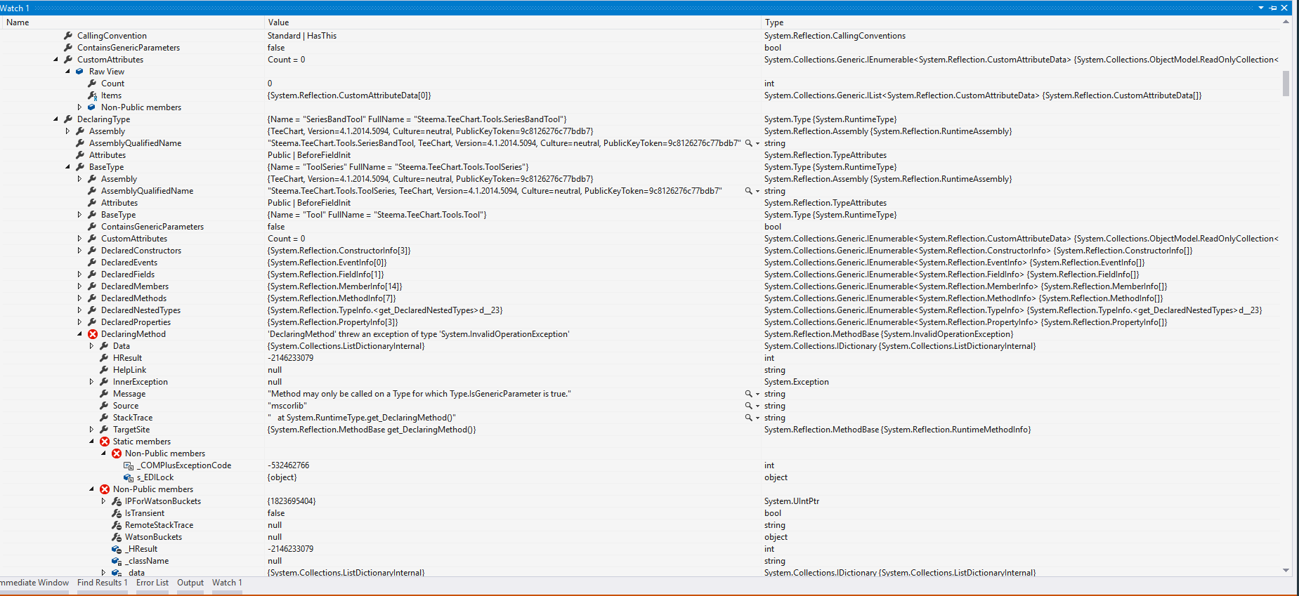

Screen-shot of the exception.
- BitMapException.png (94.07 KiB) Viewed 17727 times

These are from stack trace. I am still trying to reproduce the bug outside of my project.
- Guru
- Posts: 1603
Re: Chart.Bitmap threw an exception.
Why have you got calls to get_Bitmap() and get_Metafile()? These should not be in any normal stacktrace, as they are not called unless done so specifically in user code.Raavi wrote:"
I do not call anything expect adding 'SeriesBandTool' to chart.
I hope, I can succeed in reproducing this exception in spike solution.
