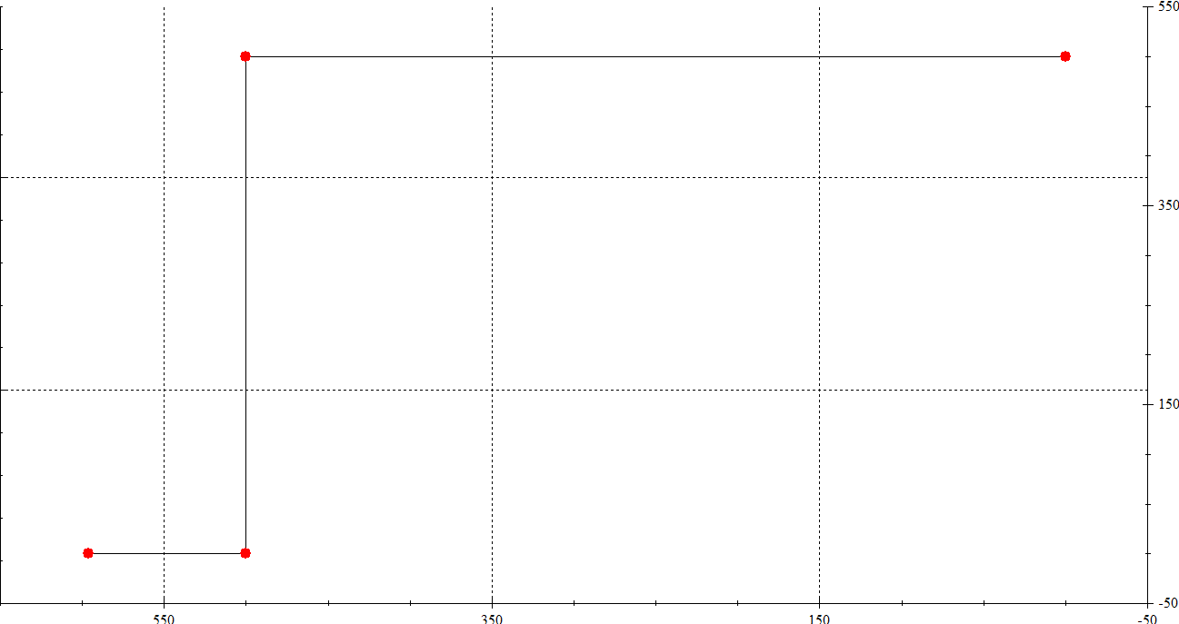

We are attaching a demo in which we are using line series with stair property to true. If we click on Inverted button, then chart bottom axis got inverted. So with respected to the axis line series must also be changed (or inverted), but it does not invert line respectively.
As shown in image below after inverting axis line changed but this is not correct.
But after inverting it shows like this that is not correct.
After inverting axis it must be like this
Please provide any solution for the same

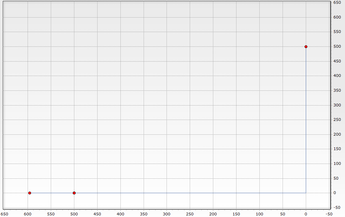

amol wrote: As shown in image below after inverting axis line changed but this is not correct.
It is one possibility. The other is to use code similar to this:
    Line line1;
      line1 = new Line(tChart1.Chart);
      line1.Add(0, 500);
      line1.Add(500, 0);
      line1.Add(600, 0);
      line1.Stairs = true;
      tChart1.Axes.Left.MaximumOffset = 20;
      tChart1.Axes.Left.MinimumOffset = 20;
      tChart1.Axes.Bottom.MaximumOffset = 20;
      tChart1.Axes.Bottom.MinimumOffset = 20;
      tChart1.Axes.Bottom.Inverted = !tChart1.Axes.Bottom.Inverted;
      line1.InvertedStairs = !line1.InvertedStairs;
