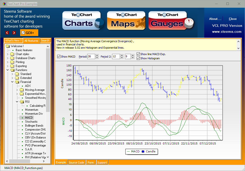

You can find examples of how to use those functions in the features demo shipped with the binary installation:
To create them at runtime, the process is very similar in all them. A part from the source series, you also need a series associated to the function.
Also note in general you want to associate this second series to a custom axis or to a different chart because it will probably have a different range of values then the source series. Here note the function may create extra series internally so you should assign this custom axis to the series' function before assigning the datasource.
