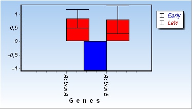

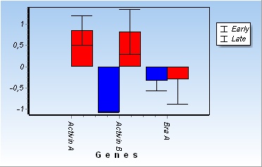

This solution does not work for me. Not only that the legend does not have correct text color, it is not possible to change it with the Toolbox. I am using ErrorBar serie.
I am using Tee Chart Pro v2015.14.150120. I have to add that this error introduced in the latest release. I have not changes my coding after updating the Tee Chart.
Procedure myProcedure;
var
   MySeries: TErrorBarSeries;
  CL: TColor;
Begin
   CL := clRed;
Chart1.FreeAllSeries(nil);
Chart1.Legend.Visible := true;
Chart1.Legend.FontSeriesColor := true;
Chart1.Legend.LegendStyle := LsSeries;
MySeries := TErrorBarSeries.Create( Self );
Chart1.AddSeries( MySeries );
MySeries.ParentChart := Chart1;
MySeries.Title := 'myTitle';
MySeries.Color := CL;
MySeries.ErrorStyle := essTopBottom;
MySeries.AddErrorBar(indx,valAverage,valSEM,'Text1',CL);
Here are the images from the previous version and the new version of Tee chart:
As you can see "Early" and "Late" do not have the same color as the bars.
Please adivise how to solve this issue.

Re: Series Chart color and Legend Chart color.
Post by Yeray » Fri Oct 02, 2015 1:41 pm
Give it a try at the latest version, v2015.16. I could reproduce the problem with v2015.14 but not with the latest version.
emwamin
Posts: 10
Joined: Tue Sep 22, 2015 12:00 am
Post by emwamin » Wed Oct 07, 2015 7:47 am
I have upgraded to v2015.16 and can confirm that the problem is solved.
Thanks a lot.
