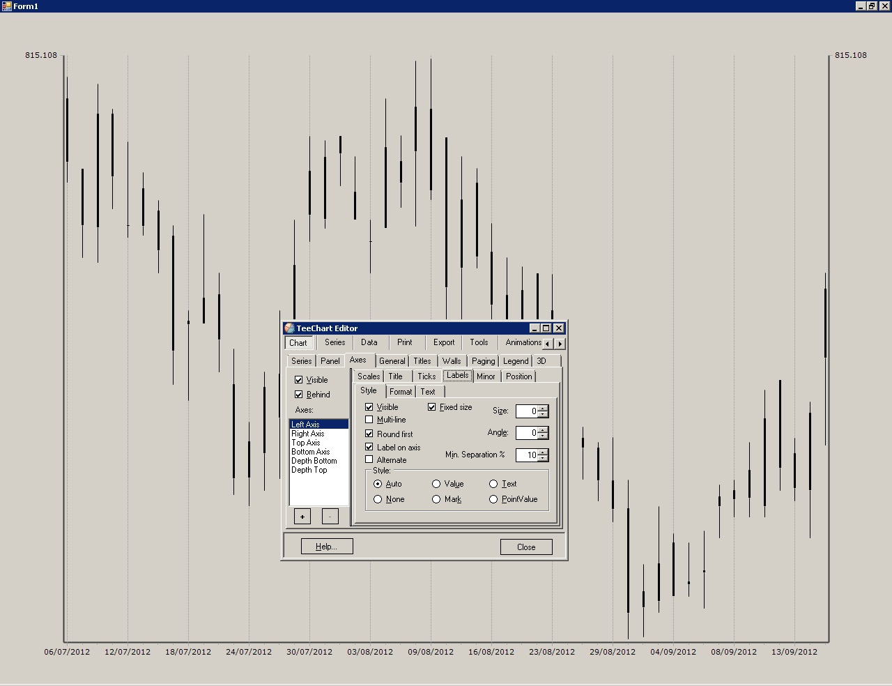

Post by Quant » Tue Apr 21, 2015 6:42 am
TeeChart Error.jpg (155.61 KiB) Viewed 8305 times
We are having some strange issue as shown in attached image. It shows left and right axis with only one value. The problem comes while we referenced TeeChart35 (.Net) project instead of TeeChart.dll in this sample application. Please let us know the solution asap.

Re: TeeChart35 .Net Project Issue
Post by Christopher » Tue Apr 21, 2015 3:38 pm
As you have the source code version, you can change the MinimalDifference() method of Utils.cs to the following:
    public static bool MinimalDifference(double value1, double value2, int units)
      long lValue1 = BitConverter.DoubleToInt64Bits(value1);
      long lValue2 = BitConverter.DoubleToInt64Bits(value2);
      // If the signs are different, return false except for +0 and -0.
      if ((lValue1 >> 63) != (lValue2 >> 63))
        if (value1 == value2)
          return true;
        return false;
      long diff = Math.Abs(lValue1 - lValue2);
      if (diff <= (long)units)
        return true;
      return false;
That will resolve the issue.
