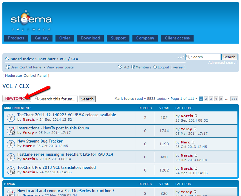

I've split this message you posted in this thread to a new thread here.
To open a new thread, you should go to a forum category (ie VCL / CLX) and click on the "NEWTOPIC" button:

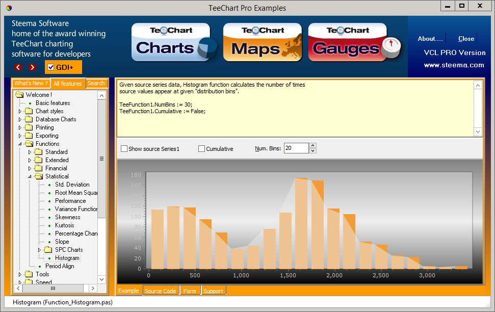

I'd suggest you to read the "Tutorial 7 - Working with Functions", shipped with the binary installation, to understand how the functions work in TeeChart.
Then, you'll find example about the Histogram function at "All features\Welcome !\Functions\Statistical\Histogram" in the Features Demo program also shipped with the binary installation. Look at the "Source Code" and "Form" tabs at the bottom to find all the code (Delphi).
