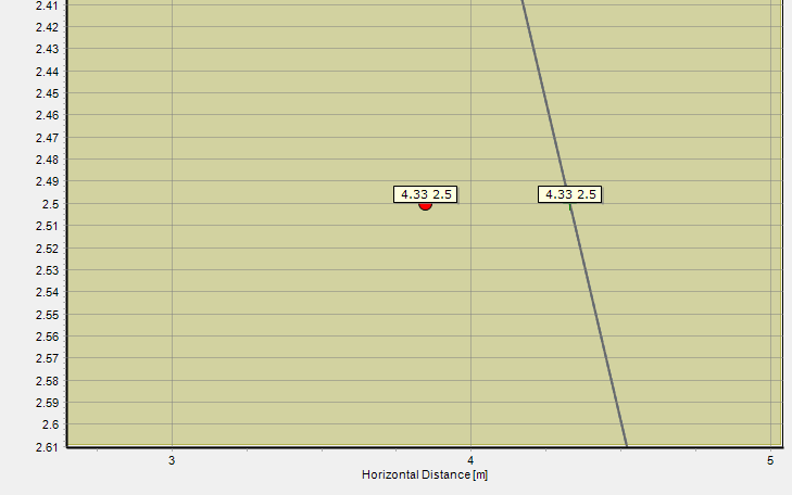

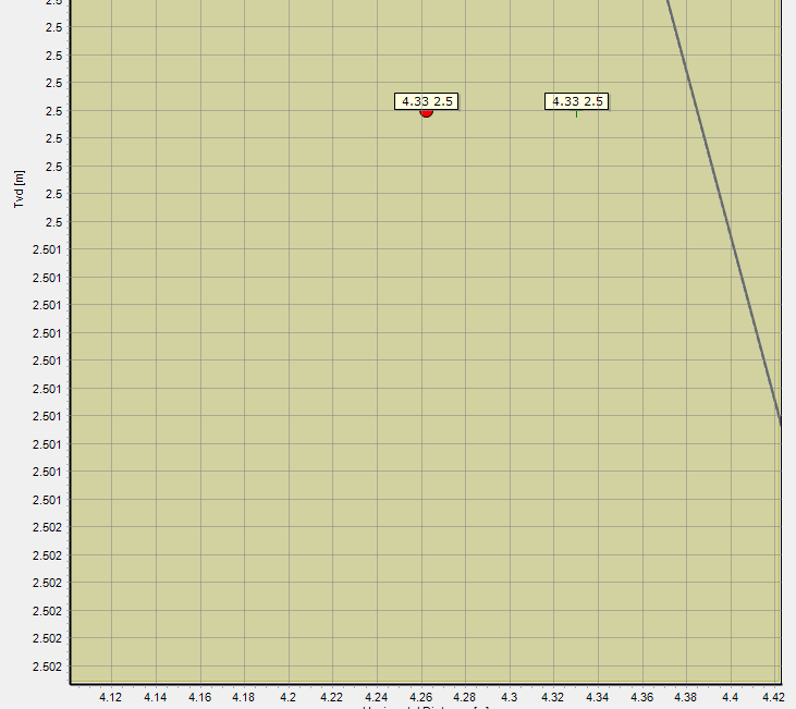

Hi!
I have a plot with a line and several point series.
Whe I zoom in the point and the line is not synched any more, even to pints series that should be in same location is in position correctly.
Or if I zoom even further.
The points marks are the same, but they are positioned in different locations, why?
Odne
repositioning of points when zooming problem #2.PNG (28.05 KiB) Viewed 5229 times
repositioning of points when zooming problem #1.PNG (16.62 KiB) Viewed 5221 times
