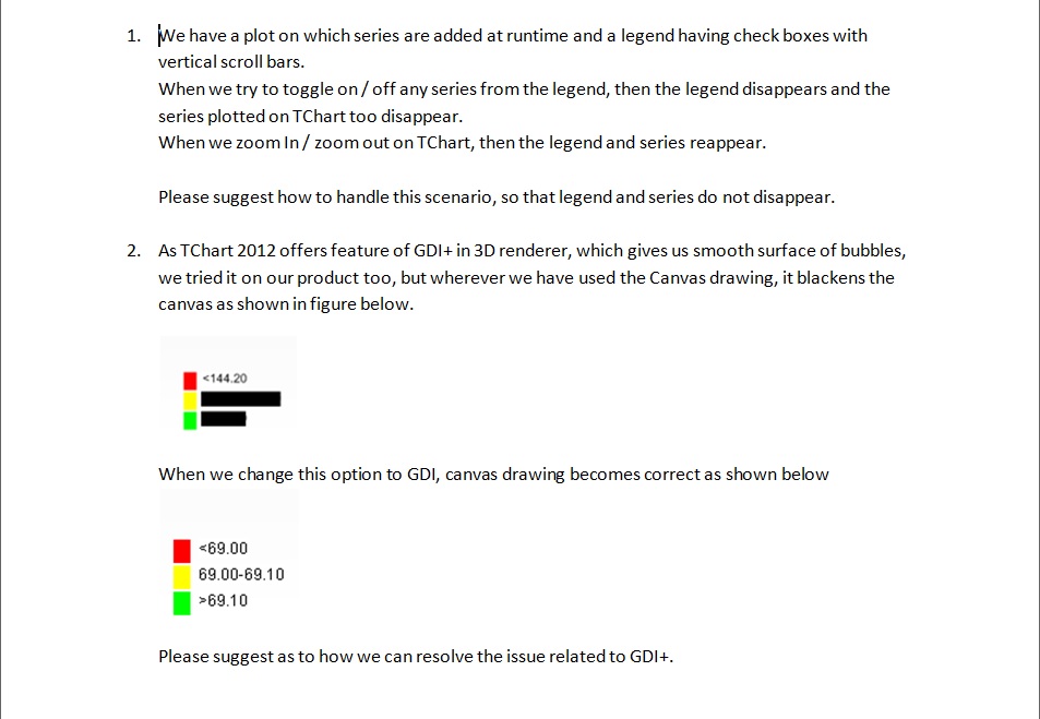

We have upgraded from ActiveX 2007 to ActiveX2012, While migrating we encountered a few issues which are as follows. I am attaching a jpg with the issues.

1. I've been trying to reproduce it with v2012.0.0.7 and the following code, but it seems to work fine for me here:
  TChart1.Aspect.View3D = False
  Dim i As Integer
  For i = 0 To 20
    TChart1.AddSeries scLine
    TChart1.Series(i).FillSampleValues 5
  Next i
  TChart1.Tools.Add tcLegendScrollBar
  TChart1.Legend.CheckBoxes = True
Please, give it a try at the actual evaluation version to see if the problem is still there, and, if still reproducible, try to arrange a simple example project we can run as-is to reproduce the problem here.
2. You can make sure you have a transparent bush before calling the TextOut function:
  TChart1.Canvas.Brush.Style = bsClear
  TChart1.Canvas.TextOut 100, 100, "hello chart"
