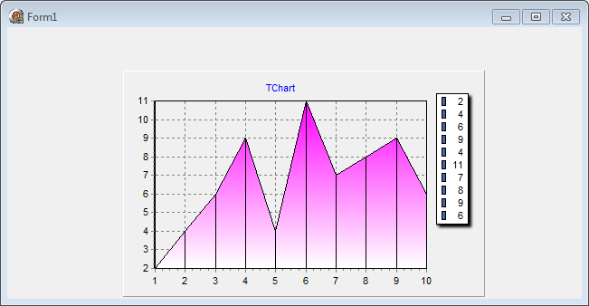

Using TeeChart Pro v8.06.60902 VCL with Delphi 2010. On a form with just a default TChart component, I have the following code:
var
  LLineSeries: TLineSeries;
  Chart1.View3D := false;
  LLineSeries := TLineSeries.Create(Self);
  LLineSeries.DrawArea := true;
  LLineSeries.Gradient.StartColor := clWhite;
  LLineSeries.Gradient.EndColor := clFuchsia;
  LLineSeries.Gradient.Visible := true;
  LLineSeries.AddXY(1,2);
  LLineSeries.AddXY(2,4);
  LLineSeries.AddXY(3,6);
  LLineSeries.AddXY(4,9);
  LLineSeries.AddXY(5,4);
  LLineSeries.AddXY(6,11);
  LLineSeries.AddXY(7,7);
  LLineSeries.AddXY(8,8);
  LLineSeries.AddXY(9,9);
  LLineSeries.AddXY(10,6);
  Chart1.AddSeries(LLineSeries);
which gives me the following:

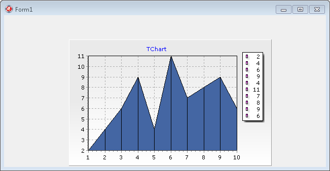

Using TeeChart Pro v2012 Build 2012.07.121105 VCL with Delphi XE3. The same code give me:
No gradient is applied and even the gradient color is ignored. I am not sure if that's a bug but in any case the behaviour has changed.

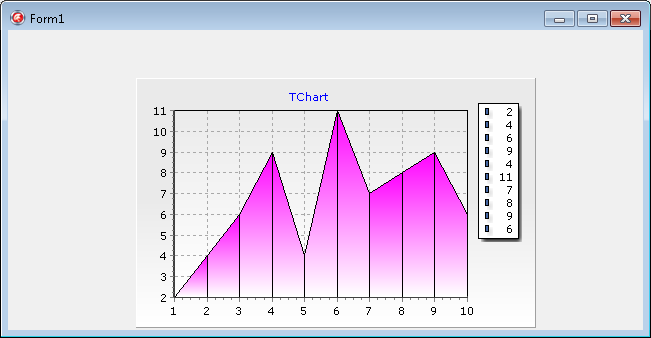

I saw that in the latest TeeChart Pro TLineSeries has an AreaChartBrush property which I using in the following way:
but the gradiant balance is changing for each point area which is different from what I had before.
How can I get back my old behaviour as in my first screenshot?

Post by Yeray » Wed Jan 30, 2013 4:11 pm
Right, the Gradients had some changes in the v2010.00.
There's the request of implementing a GradientRelative property for the TAreaSeries. This would control if the gradient is considered to start at the maximum YValue for all the points or for each point. I've incremented it's priority (TV52014958).
