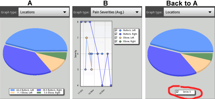

Within an Android app I am developing, I have a spinner where you can select different views of different data. Currently most of the graph types are Pie and this works ok. If I also switch from Pie to Line, that works. But if I switch from that Line chart back to a Pie chart, the chart displays ok, but the legend just displays 'Series 0'.
Here is how it looks:
This is the code which sets up the chart basics:

Anyone have any ideas why that Legend isn't repopulating?

Post by Yeray » Thu Jan 03, 2013 10:08 am
Hello Dave,
Try forcing the LegendStyle to LegendStyle.SERIES when showing your Line series:
tChart1.getLegend().setLegendStyle(LegendStyle.SERIES);
And to LegendStyle.VALUES when showing your Pie series:
tChart1.getLegend().setLegendStyle(LegendStyle.VALUES);
DaveSav
Posts: 18
Joined: Wed Jun 15, 2011 12:00 am
Re: Switching chart types loses legend
Post by DaveSav » Thu Jan 03, 2013 8:47 pm
Fantastic! That worked perfectly.
Thanks Yeray.
