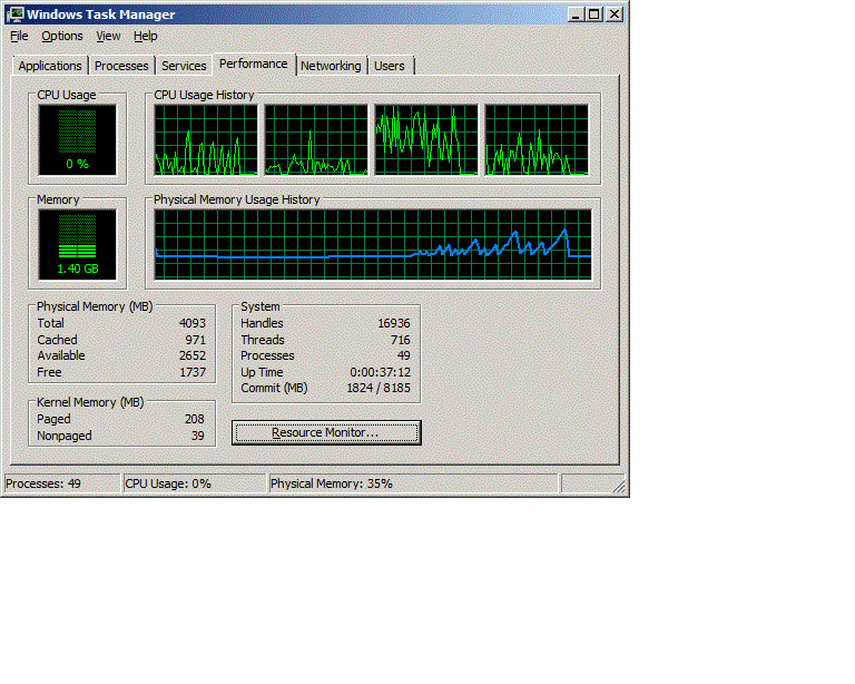

It looks like it may have to do with the frequency of updates. I made your timer interval adjustible. Once it starts updating fast, things spike. Memory usage cycles higher and higher until it stops.
When I run the chart without Bollinger Bands updating, the CPU usage and memory appear stable. If I add Bollinger bands, both begin to spike. On my 64-bit quad core machine, one processor core will peg out pretty consistantly. The memory reading cycles ever higher. This is running with the timer interval set to about 300, or updating 3 times per second. Keep in mind that stock and futures charts need to update very quickly, there is a ton of data coming in.
I rewrote Bollinger Bands myself and have a class that works. Basically, you have one class that handles each of the lines. The first class instantiated does the work and stores the data in collections. The second line is an instance of the same class, but it simply refers back to the original class to get its data. It really does no work. The net effect is that you get both lines, but you only have one set of calculations going.
In the following image you can see the chart of memory usage. You can see exactly where I turned on Bollinger Bands and where the program finally failed. I have uploaded the project file to your Upload Web page as TeeChartApp.zip.
