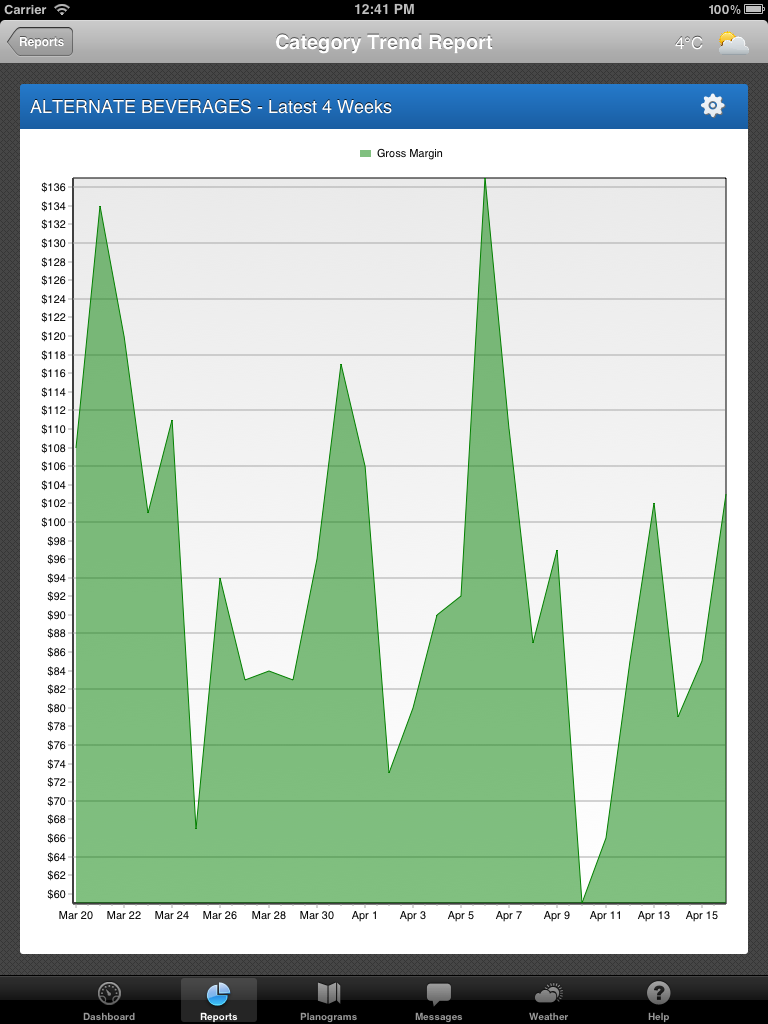

Hi, I have a chart, with days along the X Axis. In the constructor, I am setting the chart.Axes.Bottom.Grid.DrawEvery = 2 so that it displays every two days.
This works perfectly in portrait mode, but as soon as I switch to landscape, the X Axis is all messed up, and no longer following the Every 2 Days convention.
Is there something that needs to be done in order to guarantee that I am always displaying labels (and the grid) every 2 days, regardless of orientation?

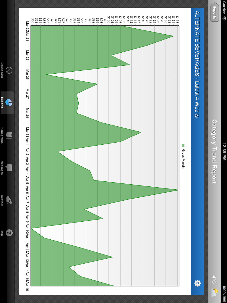

It looks as if the labels on the X Axis are not getting cleared on rotate, before the new axis labels are re-drawn. I've attached images to demonstrate this...
Any thoughts?
