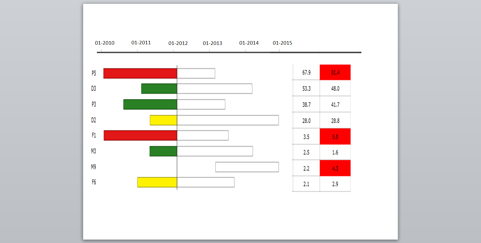

Hi Steema Support,
In our Silverlight project we are have a query related to displaying data over TeeChart as displayed in following figure.
We have to show some data in front of each bar in such a manner it should be always aligned, even if we resize graph.
Please suggest the possible solution for this query.
We will appreciate your suggestion. Thanks in advance.
Thanks & Regards
Plannoresearch

Hello Planoresearch,
You have many options to achieve it, one option I suggest you is an easy solution, you only have changed the Vertical Axis, Invert the Horizontal Axis and set marks of Bar transparent as do next:
            tChart1.Axes.Left.Visible = false;
            tChart1.Walls.Left.Visible = false;
            Steema.TeeChart.Styles.HorizBar horizBar = new Steema.TeeChart.Styles.HorizBar(tChart1.Chart);
            horizBar.VertAxis= Steema.TeeChart.Styles.VerticalAxis.Right;
            tChart1.Axes.Bottom.Inverted = true;
            horizBar.Marks.Arrow.Visible = false;
            horizBar.FillSampleValues();
            horizBar[0].Label = "F6";
            horizBar[1].Label = "M9";
            horizBar[2].Label = "F1";
            horizBar[3].Label = "D2";
            horizBar[4].Label = "P3";
            horizBar[5].Label = "D3";
            horizBar[6].Label = "P5";
            horizBar.Marks.Style = Steema.TeeChart.Styles.MarksStyles.Label;
            horizBar.Marks.Transparent = true;
The other option I suggest you is, use Annotation Tool you can find samples in the TeeChart.Net Demo, concretely: All Feauter\Welcome !\Tools\Annotation or in the Silverlight sample of Annotation.
I hope will help.
