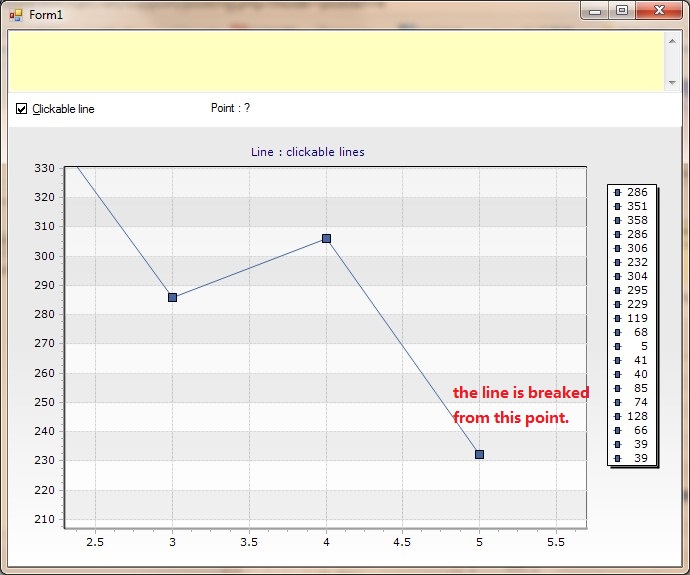

After zoomed more times,the clickable line is breaked.
sim
Posts: 19
Joined: Wed Jul 30, 2008 12:00 am
Post by sim » Wed Jan 11, 2012 7:08 am
We develop an application in .Net 3.5 in VS 2010 c#, using TeeChart Pro v 3.5.3225.32185.

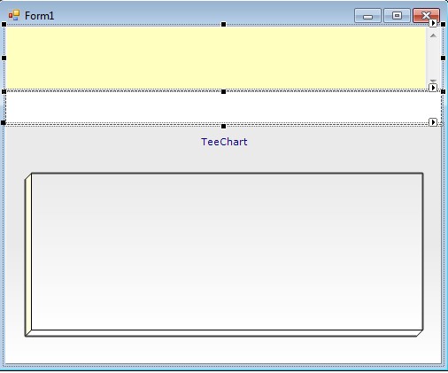

I added Form1 just like baseForm in demo .
Form1

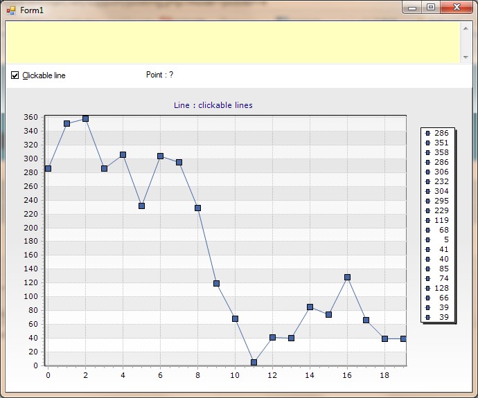

Added Form2 inherit form1 and added a line in Tchart.
The line Added in TChart
And After i zoomed it for 2 times, it is breaked.
Line is breaked.
Please help to fix this issue, thanks.
