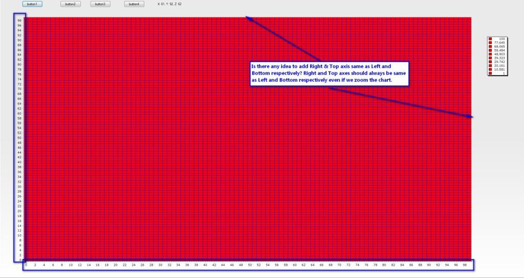

Hi Steema Support,
We are using Teechart.Net 2010 for creating a Color Grid Graph.
Is there any idea to add right & top axis same as left and bottom respectively? Right and Top axes should always be same as Left and Bottom respectively even if we zoom the chart. Currently we are setting Left and Bottom to automatic. We are also setting chart’s Top and Right automatic but nothing happens.
Any suggestion will be highly appreciated.
Thanks & Regards
Planoresearch

Hello Planoresearch,
You must do the same as I do in next lines of code:
clrGrid.VertAxis = VerticalAxis.Both;
clrGrid.HorizAxis = HorizontalAxis.Both;
Can you tell us if previous lines, works as you expect?

Hi Sandra,
Thanks for reply. Given code is exactly working fine. Our problem is resolved.
