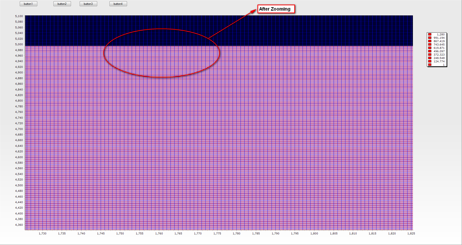

We are using TeeChart for .NET2010. I am trying to create a color grid series I which we are putting data in the manner as in following code. I have put red color in each cell of grid. I am facing problem when I am trying to zoom the chart. The color of cells are changing as soon as I zoom the chart. You can see it in attached picture.

Re: Cell Color in ColorGrid
Post by Sandra » Tue Dec 27, 2011 11:57 am
Hello Planoresearch,
I have modify a little your code to work with less data. Moreover, I have added IrregularGrid=true. Please see next:
        ColorGrid clrGrid;
            /*Chart*/
            tChart1.Walls.Visible = false;
            tChart1.Chart.Panel.Color = Color.Transparent;
            tChart1.Legend.Visible = true;
            tChart1.AutoRepaint = false;
            clrGrid = new ColorGrid(tChart1.Chart);
            clrGrid.Pen.Color = Color.Blue;
            clrGrid.UsePalette = false;
            clrGrid.UseColorRange = false;
            clrGrid.IrregularGrid = true;
            int k = 0;
            for (int i = 153/*9*/; i < 281/*9*/; i++)
                k++;
                for (int j = 0; j < 597/*6*/; j = j + 4)
                    clrGrid.Add(i, k, j, Color.Red);
            tChart1.AutoRepaint = true;
            tChart1.Refresh();
Can you tell us if using previous code your problem appears? On the other hand, can you tell us which version are you using?

Hi Sandra,
Thanks for reply. Given code is exactly working fine. Our problem is resolved.
