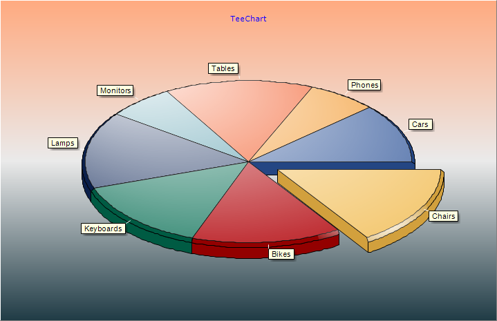

Post by Laurent75 » Wed Dec 14, 2011 4:13 pm
We don't find the detailed options to draw this graphic with our TeeChart v2011 ActiveX
Can you help us ?

Post by Yeray » Thu Dec 15, 2011 11:56 am
Take a look at this thread:
http://www.teechart.net/support/viewtop ... ork#p45039
And here you have a chart made with the actual ActiveX version, trying to simulate the chart you've mentioned.
Private Sub Form_Load()
  With TChart1
    .Aspect.GDIPlus.Active = True
    .Aspect.Chart3DPercent = 20
    .Legend.Visible = False
    With .Panel.Gradient
      .Visible = True
      .StartColor = RGB(255, 170, 128)
      .EndColor = RGB(30, 58, 68)
    End With
    .AddSeries scPie
    With .Series(0)
      .FillSampleValues
      With .asPie
        .Shadow.Visible = False
        .ExplodeBiggest = 20
        .BevelPercent = 20
        .EdgeStyle = edCurved
      End With
    End With
  End With
End Sub
