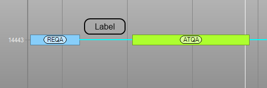

I have a Gantt serie with some bars. I want to display a line between each bar which will have a label associated.
Example with the picture below:
Label on lines example
The two blocks REQA and ATQA are connected (using the NextTasks property) and a line is displayed between them (using the ConnectingPen property).
Is there a way to add a label on this line, like for the blocks ?
Best regards.

I'm afraid this is not possible right now. However, it wouldn't be very difficult, for example, to have an array of Annotation tools to show the desired texts.

Yes, you can do that using Annotation tools set to a custom position in the OnAfterDraw event as in the example here:
    private Steema.TeeChart.Styles.Gantt gantt1;
      gantt1 = new Steema.TeeChart.Styles.Gantt(tChart1.Chart);
      gantt1.Add(DateTime.Now, DateTime.Now.AddDays(2), 1, "task1");
      gantt1.NextTasks[0]=gantt1.Add(DateTime.Now.AddDays(4), DateTime.Now.AddDays(5), 1, "task2");
      tChart1.Draw();
      for (int i = 0; i < gantt1.NextTasks.Count; i++)
        int next = (int)gantt1.NextTasks[i];
        if (next != -1)
          Steema.TeeChart.Tools.Annotation annotation1 = new Steema.TeeChart.Tools.Annotation(tChart1.Chart);
          annotation1.Shape.CustomPosition = true;
          annotation1.Text = "Connecting line " + i.ToString();
          SizeF textSize = g.MeasureString(annotation1.Shape.Font, annotation1.Text);
          int x = gantt1.CalcXPosValue(gantt1.EndValues[i]) + (gantt1.CalcXPosValue(gantt1.StartValues[next]) - gantt1.CalcXPosValue(gantt1.EndValues[i])) / 2;
          int y = gantt1.CalcYPos(i) - 30;
          annotation1.Shape.Left = x - (int)textSize.Width / 2;
          annotation1.Shape.Top = y;

Thank you very much ! I think this will be fine.
