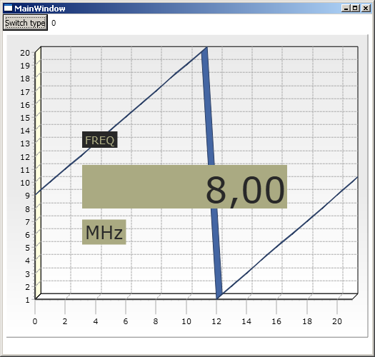

I have an issue with the NumericGauge in WPF. I'm using the latest version of teechart (4.1.2011.7283).
When The type of the series is modified, the content from the NumericGauge is not hidden:
NumericGauge issue
numericgauge issue.PNG (33.73 KiB) Viewed 2984 times
I made a small project to reproduce this issue.

Hello Antonie,
I can reproduce your problem here in WPF application, but not in WinForms application. I have attached it in bug list report with number[TW16015707]. We will try to fix it in next maintenance releases of TeeChart.Net
