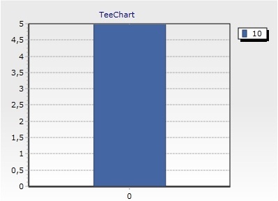

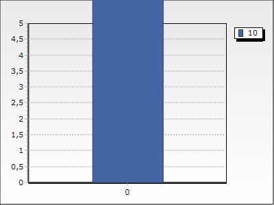

As you see, source TChart Bar (and other Series too) is out of visible area in exported XAML:
Source:
Exported:
Re: Export to XAML Bug. Series doesn't intersect by visible area
Post by Sandra » Tue Aug 09, 2011 1:59 pm
Hello neurosoft,
You are right. I have added your request in bug list report with number [TW16015691]. We will try to fix it in next maintenance releases of TeeChart.Net.
