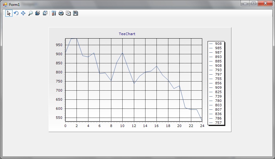

I couldn't reproduce your problem. Using next code with last version of TeeChart.net:
            Steema.TeeChart.Styles.Line line = new Steema.TeeChart.Styles.Line(tChart1.Chart);
            line.FillSampleValues();
            tChart1.Axes.Left.Grid.Color = Color.Black;
            tChart1.Axes.Bottom.Grid.Color = Color.Black;
I have get next Image:
So, using last version of TeeChart.Net Grid Axes property change its color fine. Can you tell us which version of TeeChart are you using, now?

Can you tell us if your problem appears in the attach image there is in previous post? On the other hand, I inform you that the newest version is build 4.1.2011.06282, please update your version and try again if your problem persist.
