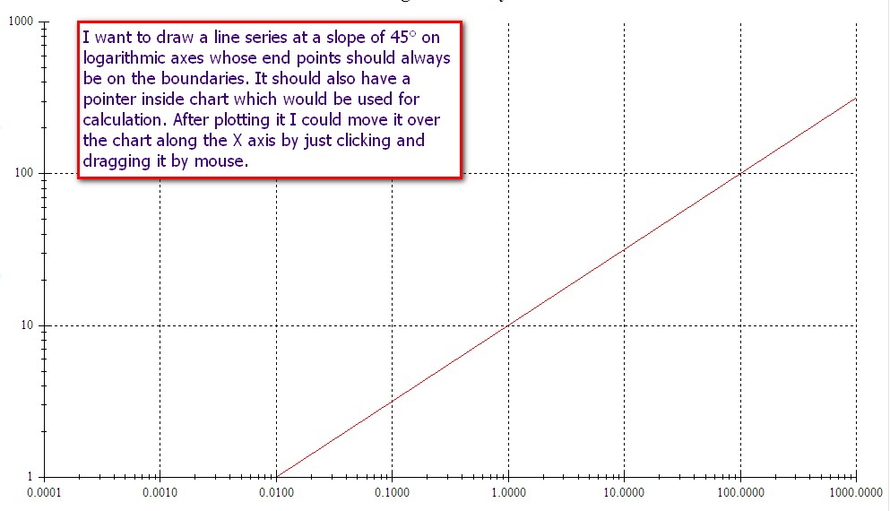

I have a chart with logarithmic axes. In this chart we need a line which will be on half slope (45°) and its end points always touches the boundaries of the chart (We have done this by your help provided in last post). But the major part of the requirement is that we can move this line along X- axis by just clicking it and moving mouse over the chart. While moving the line, its end points should always be boundaries. I have successfully made this type of chart for linear axes, but for logarithmic axes I am still grappling.
The project attached in fifth post may be helpful for you to understand. In this project there are two forms. Form1 have a chart with Logarithmic axes and Form2 have Non- Logarithmic axes. Please run both the forms. I want the movement of half slope line in form1 as in form2.

To know what I am trying to do, you can see fifth post. You can also see the project attached. Anyways I am explaining it once again:

Back to your application, I see you try to draw a line with a given slope. And you want that line to be draggable in a logarithmic axis maintaining the sople or angle.
- First of all note that you have to calculate the coordinates of the dragged line and, as more points in the series, more points you'll need to calculate. I mean, since a line is drawn with two points, why to have three?
- You use the clicked method at MouseDown event to check if the line is clicked. Then, at MouseMove event, you try to recalculate the coordinates of the points. As these points will cut the ChartRect, I see this problematic pretty similar to the problematic in the other thread, where you try to do exactly the same but with a DrawLine tool. So the code should look very similar to the code in there. The main difference is that the DrawLine tool takes pixels as coordinates, while a Line series has to be set with axes values. So you'll have to transform the coordinates calculated in the DrawLine example, and transform them to axes values with CalcPosPoint function.
Taking your example and the code from the DrawLine tool thread, with some little modifications, it seems to work fine for me here. This is the code I use to calculate the two Line points:
In the last post of the mentioned discussion I suggested you a way to achieve the last problematic you exposed. If you found any other problem with the workaround or anything else we'll be pleased to hear about it (please, do it in the according thread if you want us to take a look at it).Amol wrote:There are some restraints so I cannot use DrawLine tool. I had a long discussion about this in the posts available at the link you provided. At last I found that Draw Line cannot help me.
I think the problem in your code is regarding the relation and transformation from screen pixels to axes values and vicevesa. I'd suggest you to take a look at the following thread to understand the purpose of CalcPosValue and CalcPosPoint functions.Amol wrote:It will be so kind of you if you please provide the solution using Line series.

Re: Line movement
HI Yeray,
Thanks you very much for giving your precious time. I told you earlier some reason why I cannot use ‘DrawLine’ tool. Now our project is growing huge. We have created lots of this type of graph in our project using Line Series (but with non logarithmic axes). There are some dependencies of those plots with each other. As we are continuously using line series, it will be difficult to have Draw Line in some plot and in some Line Series. Also there are some synchronisations which could be lost by using DrawLine tool. One more thing was also there, as discussed that we could not find it in legend. If we create custom legend then it will be very difficult to maintain real-time synchronization as already present in default legend of Tee chart.
Once again I am explaining what I am trying to do(as attached figure): I want to draw a line series at a slope of 45° on logarithmic axes whose end points should always be on the boundaries. It should also have a pointer inside chart which would be used for calculation. After plotting it I could move it over the chart along the X axis by just clicking and dragging it by mouse. I am still working on it using Line series but meanwhile if you get anything
for me then please let me know.
Please help me.
Thanks and regards
Ashish Pandey
As you suggested, for understanding CalcPosValue and CalcPosPoint functions, I am trying to get it correctly.I'd suggest you to take a look at the following thread to understand the purpose of CalcPosValue and CalcPosPoint functions.
Please help me.
Thanks and regards
Ashish Pandey
Re: Line movement
Hello Ashish,
A part from this, the concepts explained above should be enough to calculate the line values to draw your 45º slope. Here it is the complete Form1 that does it for me. The only thing I'm not sure why it isn't working as I'd expect is how the line looks the first time it is drawn. Maybe you can find what I'm missing.
But it seems to work as I'd expect when you drag it, isn't it?
I see, since you want a line with a central pointer visible, this line has to have minimum 3 points. You could use the line series GetPointerStyle event to show the pointer with index=1 and hide the pointers with index=0 and index=2.Amol wrote:Once again I am explaining what I am trying to do(as attached figure): I want to draw a line series at a slope of 45° on logarithmic axes whose end points should always be on the boundaries. It should also have a pointer inside chart which would be used for calculation. After plotting it I could move it over the chart along the X axis by just clicking and dragging it by mouse. I am still working on it using Line series but meanwhile if you get anythingfor me then please let me know.

Re: Line movement
Thank you very much for the code you provided in above post. I have no words to explain how you helped me. Your support has been tremendous.
As an independent project it is working fine. Now we will incorporate it in out project and let you know the status. Hope it’ll work same here.
Thanks and regards
Ashish Pandey
Thanks and regards
Ashish Pandey
