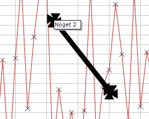

I found another workaround – in the NewLine event I set the sender.EnableDraw = false, and then create a new instance for each line I need.
Anyway – now I got another problem I can’t seem to figure out.
I would like the lines to be rather wide (10pix), resulting in that the ‘selecting points’ (I guess these are called Start- and EndHandles?) gets rather large (please see picture below).
Is the any way that I can set the size of these, or hide them, or ... (see next picture), makeing it look nicer? I know this is a rather dump question, but I just can’t figure it out.
Thanks a lot in advance
Christian

Sorry for not making myself clear. I was wounding if there were any way to make the Annotation.Callout arrow point at the selected point instead of the selected point instead of the Annotation itself. So something like in my post from "29 Apr 2011 11:08", pic: DrawLine2.jpg.

At the moment the annotation callout points at the annotation textbox. So the arrow points from a point on the graph to the textbox.
What I would like the callout to do, is to points from the textbox, to a point on the graph. Kind of like the picture from my post "29 Apr 2011 11:08", pic: DrawLine2.jpg.
Kind of simple right? And its properly me being unable to see the wood from all the trees, but I just cant seems to figure it out.
