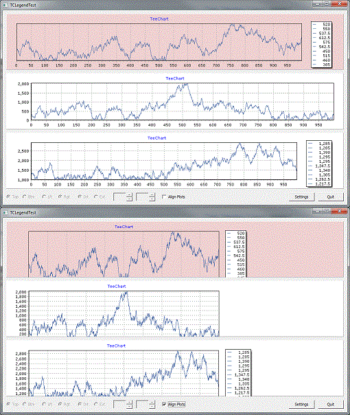

Can do. I adapted something I was using to play with the legend (and related to an older post I made that I hope to eventually get back to) before I got pulled away from this whole thing for a little while. So ignore the legend-y looking controls at the bottom. I also removed all that code to just focus on this. Anyway, I was looking at this and noticed that the left and right sides are aligning but that they are doing so in a way other than what I'm looking for. The ChartRect I set bounds the entire image, labels, legend and all, and I want to only specify the actual plot bounds and let TeeChart put the axis labels and legend where it wants to relative to that. This also effects the top and bottom as you can see. Even though I specifically set the ChartRect top and bottom to the values given by GetChartRect, the plot shrinks. It's weird because GetChartRect returns the plot boundaries as expected but setting that property includes the other elements. I can mock up screenshots of the before and after that I'm looking for, if that will help.
Another issue can be seen by:
1) Start the program.
2) Check "Align Plots."
3) They resize somewhat correctly in the manner I described above.
4) Uncheck "Align Plots."
5) Resize the window again.
6) Check "Align Plots" again.
7) They resize to the rectangles that were calculated the first time and NOT relative to the default positions set after step 5. I'm not using any static members or variables and TRACE statements show that ChartRect is being called with the correct values.

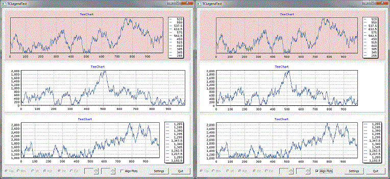

Okay, I've finally stopped dancing long enough to reply. Yeray, you are my hero. I've been fiddling with this off and on for ages, trying to find the right combination of function calls, metrics, and math to do exactly what your snippet does. Thanks a million! I still get the other problem I described though; setting the ChartRect once results in those values being used every time.
Image 1 is what happened when I aligned the plots the first time. Perfect. Image 2 is what happened after I turned off the alignment, resized the window, then aligned again. As you can see, the "After" part of Image 2 put the plots in the same position as the "After" part of Image 1. However, the ChartRect calls in both cases look correct:
Image 1:
m_topPlot.ChartRect(65, 8, 702, 187);
m_midPlot.ChartRect(23, 8, 617, 187);
m_btmPlot.ChartRect(23, 8, 716, 187);
Image 2:
m_topPlot.ChartRect(73, 7, 942, 156);
m_midPlot.ChartRect(31, 7, 857, 156);
m_btmPlot.ChartRect(31, 7, 956, 156);
