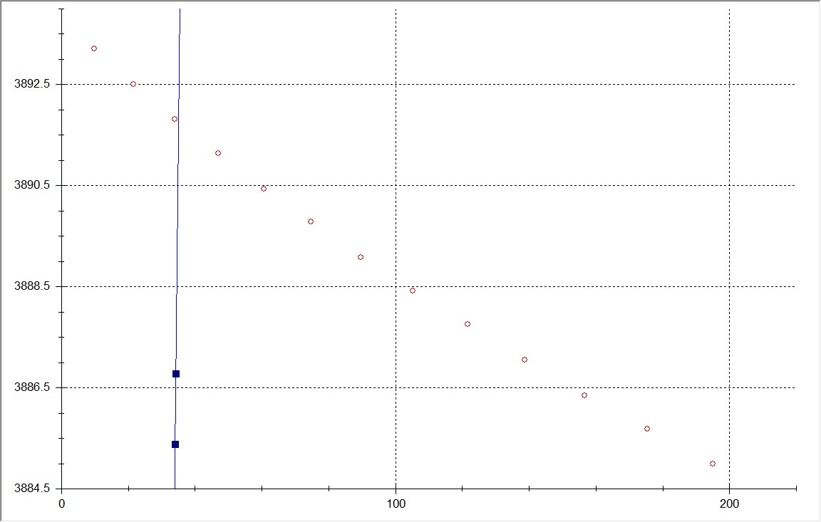

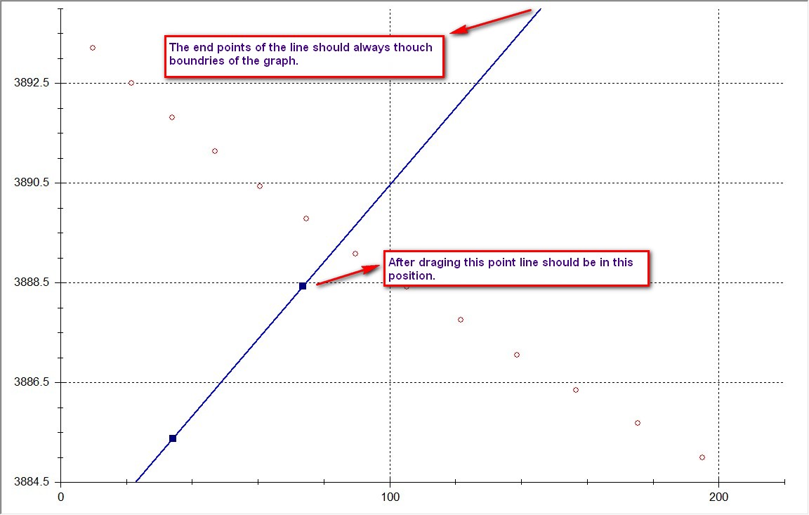

I am creating a line series having two points. I can also move these points by clicking and dragging it by mouse so that whole line may change. My requirement is, to create a straight line in which the line passing through these points should always touch the boundaries of chart even when I move it. In addition I can say the series which I see on chart every time should always be a straight line.
For more help I am sending you two snaps of my requirement. First snap shows initial position of graph, and second one shows the series after moving it by mouse.
Initial Posiition of Points.jpg (67.59 KiB) Viewed 24228 times
Second Position of Point.jpg (95.25 KiB) Viewed 24210 times

1. Suppose one straight line drawn on tee chart (In such manner that the end points of line touch the boundaries of tee chart).
2. On that straight line. Two pointers are being displayed in mid of line (Points are not overlapping).
3. Now drag any one pointer then straight line should also drag along with this point joining with other pointer and line should always touch the boundaries of tee chart. (As mentioned in point 1).
Hope you understand what I am trying to convey you. In short, I have one straight line drawn on tee chart having two pick points. When we drag any pick point then that straight line should also move with that pick point and on tee chat that straight line should always present which is passing through those two pick points and touching the tee chart boundaries.
Another problem –
I have one straight line drawn on tee chart at any slope say 45 degree. Now drag that line and drop at another location. Line should drop with same slope, In this case 45 degree.
Please help me as soon as possible.
