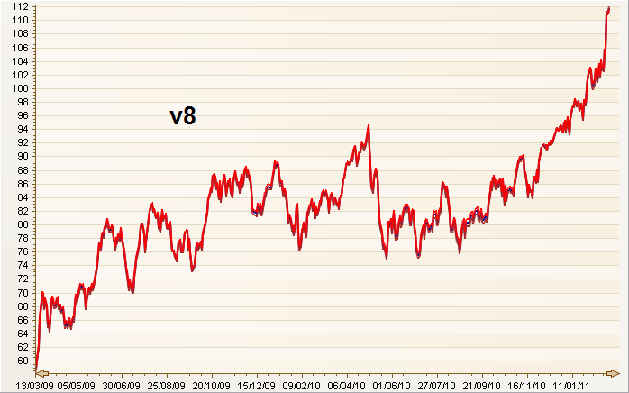

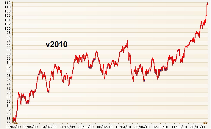

Post by guilz2010 » Mon Feb 28, 2011 11:38 am
When anti-aliasing tools is used and when you scroll the chart with the axis scroll tools, the chart is not smoothed
After a resize, the smooth is back !

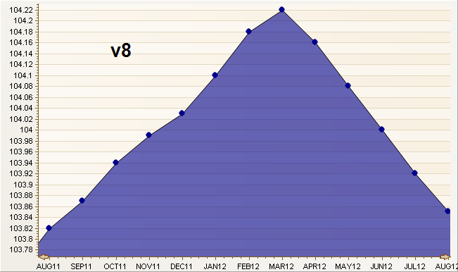

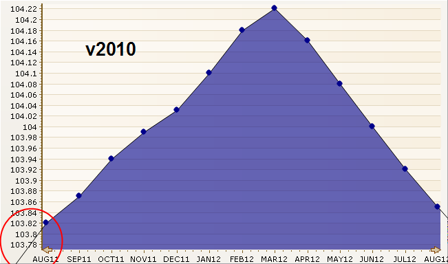

guilz2010
Posts: 63
Location: Paris, France
Re: v2010 - Bugs List
Post by guilz2010 » Mon Feb 28, 2011 12:18 pm
- after displaying the TeeEditor, the rectangle used to select a zoom area is not correctly displayed

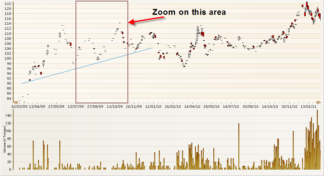

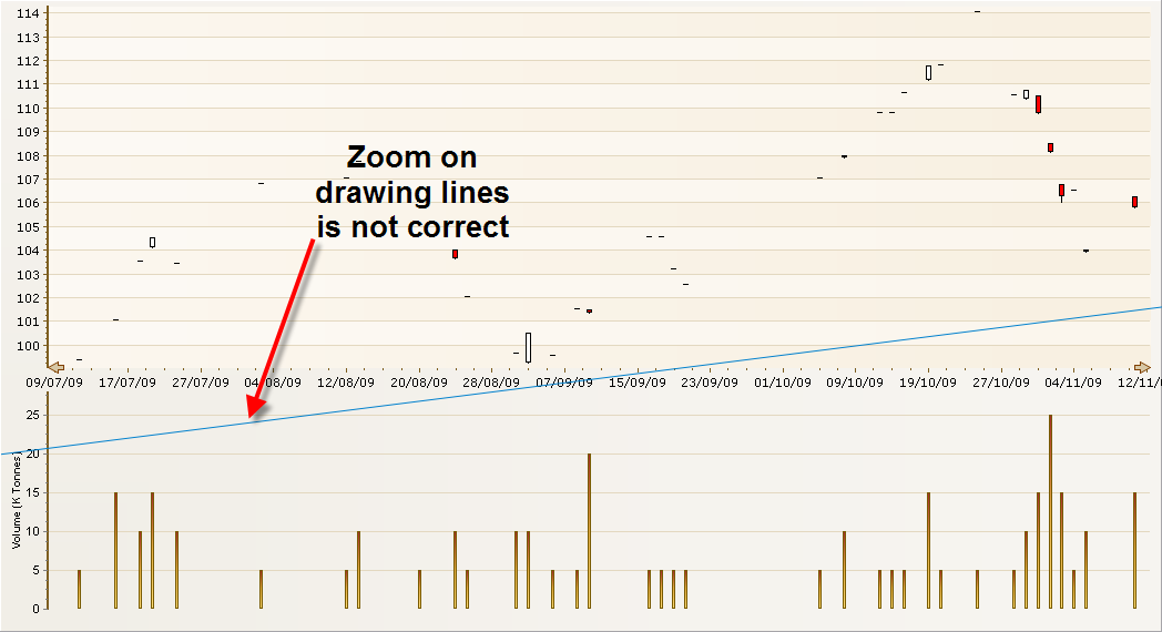

Post by guilz2010 » Mon Feb 28, 2011 1:11 pm
There is a bug when we try to zoom on drawing lines (v8 and v2010 version)
Post by Sandra » Tue Mar 01, 2011 4:38 pm
Hello guilz2010.
Thanks for your information, finally I could reproduce your problem. And I have communicate some things.
To solve your first and third problems, I recommend that you try to use ClipPoints property of Chart as do in next line of code:
TChart1.ClipPoints = True
Your second problem is a bug and I have added your request in bug list with number [TV52015427]. We try to fix it for next versions of TeeChart. Meanwhile, you can take a look to TeeChart Activex Demo Project, concretely in All Features\Axes\Opaque Zones. You have to consider that if you want to see that demo of opaque zones works as you expected, you need disable GDI+ checkbox of demo Project.
