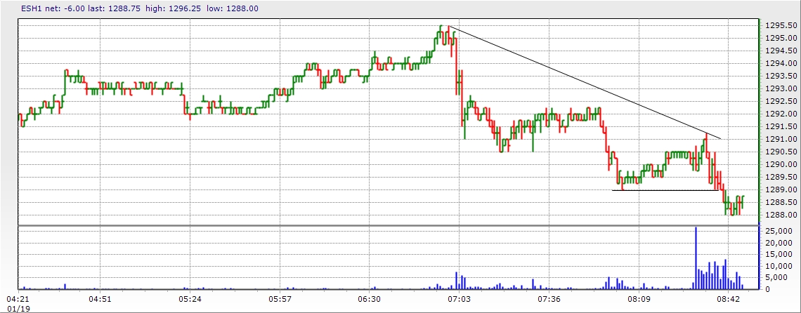

The following image is a screen shot of a chart that will update live. Notice that there are two trend lines that have been drawn on the chart. They may represent support or resistance lines on which the user wants to keep watch. Because they are simply line segments that have distinct start and end points, as time goes by those lines are going to scroll to the left, and eventually off the visible portion of the chart. It would be very handy to have a line style which, when positioned by the two points, autmatically drew themselves off to the right hand side of the chart. (They do not need to extend to the left since that is old information.) As new bars are added to the chart and the old data scrolls to the left, the chart Redraw function would again extend the line to the right.
ESH1 Chart

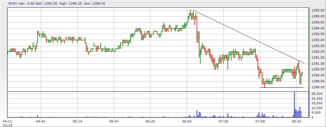

Here the chart has had a few minutes to add some new bars. You can see how the trend lines are moving left with the chart. I am looking for a way to make the right-most end of the line fire out to the right side without the user having to modify anything.
Hope this makes sense!
Second Chart
