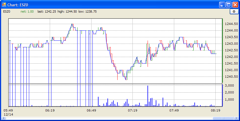

Here is an example. If one does a 1-day moving average of the close, the moving average line should connect each successive bar's close. You can see in the image below where the moving average line drops to 0 (presumably) on each bar where there is no data.
Chart Image - 1day Average

Hello Dave,
You have different options:
1.- You can use property of average IncludeNulls to false and function will be calculated without null points. You also can change property of Line TreatNulls to DoNotPaint . You can do something as next:

I had the Average.IncludeNulls = False in there. I had missed the TreatNulls = DoNotPaint. That was the key. Thank you very much for the timely answer. We are good to go now!
