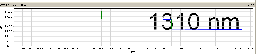

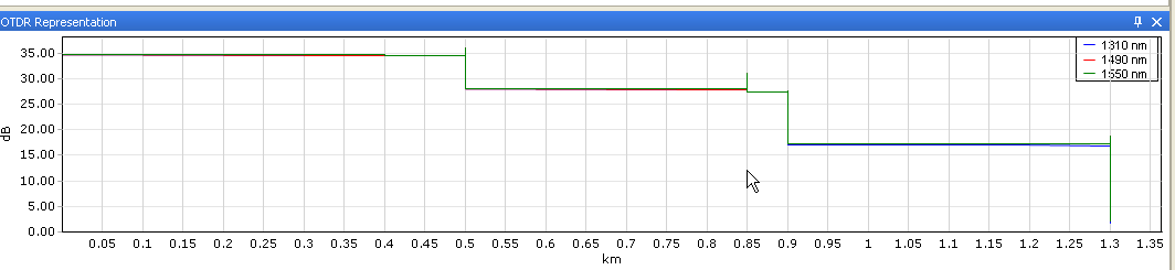

Hi We have drawn a legends on the chart.
we have set
Legend.ResizeChart = false
It is seen that the grids on the chart are ovelapping on the legends
ScreenHunter_02 Nov. 09 15.09.gif (11.73 KiB) Viewed 3745 times
to see the impact we have zoomed the legends and horizontal grid lines
ScreenHunter_01 Nov. 09 14.23.gif (13.64 KiB) Viewed 3748 times
requesting to provide proper solution and cause of this defect

Hi Pradip,
You already mentioned the cause of this issue, which is setting Legend.ResizeChart to false. Setting it to true would solve the issue. If that's not what you are looking for what would you expect to get when setting ResizeChart to false or how and where would you like the legend to be plotted?
