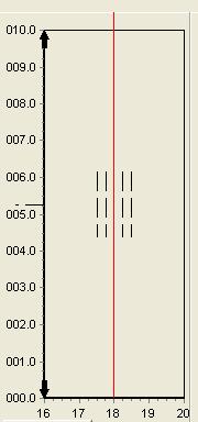

Post by roger » Mon Oct 25, 2010 9:43 am
I am now trying with Teechart ActiveX Pro 8 version and seems that the older problems are resolved.
But now when i am using the code to drawline which was perfectly drawing lines in version 7 seems to have some problem in version 8.
I am using following code
	CPen1 penMass1 = m_canvas[nChartIndx].GetPen();
	penMass1.SetColor(PEN_COLOR_RED);
	penMass1.SetStyle(psSolid);
	Y0 = m_graph[nChartIndx].GetAxis().GetTop().GetPosition();
	Y1 = m_graph[nChartIndx].GetAxis().GetBottom().GetPosition();
	m_canvas[nChartIndx].DrawLine(X0, Y0, X1, Y1);
	// drawing line intersecting Y axis
	penMass1.SetColor(PEN_COLOR_BLACK);
	penMass1.SetStyle(psDash);
	long YMid = (Y1 + Y0) / 2;
	X0 = m_axisLeft[nChartIndx].GetPosition();
	X1 = m_axisRight[nChartIndx].GetPosition();
	X1 = m_graph[nChartIndx].GetAxis().GetRight().GetIStartPos();
	m_canvas[nChartIndx].DrawLine(X0, YMid, X1, YMid);
To draw an vertical and horizontal line but
it is not drawing the horizontal line properly,. Would you please help me??
Horizontal line not drawn

Post by Narcís » Mon Oct 25, 2010 11:36 am
Hi roger,
I'm afraid some code is missing here to be able to reproduce the problem. Anyway, code snippet below works fine for us here. Does it works fine at your end? Can you please attach a simple example project we can run "as-is" to reproduce the problem here?
