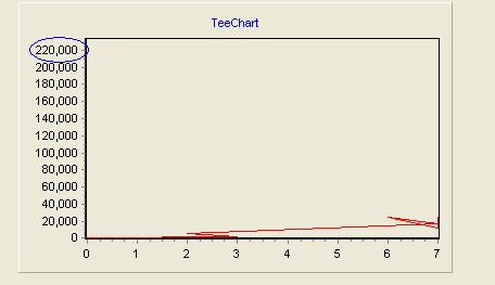

Maximum and minimum returns the values of X/Y
Where as I want the maximum label in left axis. I am attaching an image where the left axis last label is rounded which must be retieved from the code
[img]
Rounded value is to be retrieved
[/img]
Re: Scroll event implementation
Post by Narcís » Wed Sep 29, 2010 9:54 am
Hi roger,
In that case you can use OnGetAxisLabel or OnGetNextAxisLabel event for that.
