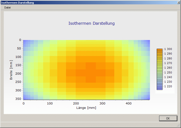

i'd like to realize a isothermal plot with your software.. therefor i read in a csv file with three columns (X position, Y position, and Z for the temperature) and save it into a list of arrays.
The X and Y position is the top left position of each cell. You can load it here: http://rapidshare.com/files/413439287/2dtemp.csv
Then i plot it with a grid.. Here the code:

It produces this plot:
My Questions are:
1) I want to have a colorpallete from blue to red to yellow to white (like hot steel) - how can i do this?
2) I use CenteredPoints = true, but teechart is not plotting it in the center (see screenshot above). How can i do this?
Thanks a lot for your support!
Re: isothermal plot - change colorpalette & center X and Y pos.
Post by Yeray » Tue Aug 17, 2010 1:38 pm
Hi kint,
kint wrote:1) I want to have a colorpallete from blue to red to yellow to white (like hot steel) - how can i do this?
You should set ColorGrid's custom palette as described here.
kint wrote:2) I use CenteredPoints = true, but teechart is not plotting it in the center (see screenshot above). How can i do this?
I'm afraid that CentredPoints has some problems with some data as discussed here. This is already in the defect list.
Post by Sandra » Wed Aug 18, 2010 9:49 am
Hello Kint,
I think that you can use custom labels as does in next example that you can use as workaround:
            Steema.TeeChart.Styles.ColorGrid colorGrid1 = new Steema.TeeChart.Styles.ColorGrid(tChart1.Chart);
            colorGrid1.IrregularGrid = true;
            //colorGrid1.CenteredPoints = true;
            Random y = new Random();
            for (double x = 0; x < 2; x = x + 0.1)
                for (double z = 0; z < 2; z = z + 0.1)
                    colorGrid1.Add(x, y.Next(), z);
            tChart1.Panel.MarginBottom = 10;
            tChart1.Axes.Bottom.Labels.Items.Clear();
            int nCol = (int)Math.Sqrt(colorGrid1.Count);
            for (int i = 0; i < nCol - 1; i++)
                double left = colorGrid1.XValues[i * nCol];
                double right = colorGrid1.XValues[(i + 1) * nCol];
                double mid = (left + right) / 2;
                int pos = tChart1.Axes.Bottom.CalcPosValue(mid);
                if ((pos >= tChart1.Axes.Bottom.IStartPos) && (pos <= tChart1.Axes.Bottom.IEndPos))
                    tChart1.Axes.Bottom.Labels.Items.Add(mid);
            tChart1.Panel.MarginLeft = 10;
            tChart1.Axes.Left.Labels.Items.Clear();
            int nCol1 = (int)Math.Sqrt(colorGrid1.Count);
            for (int i = 0; i < nCol1 - 1; i++)
                double left = colorGrid1.XValues[i * nCol1];
                double right = colorGrid1.XValues[(i + 1) * nCol1];
                int pos = tChart1.Axes.Left.CalcPosValue(mid);
                if ((pos >= tChart1.Axes.Left.IStartPos) && (pos <= tChart1.Axes.Left.IEndPos))
                    tChart1.Axes.Left.Labels.Items.Add(mid);
Could you tell us if previous code works as you want?
