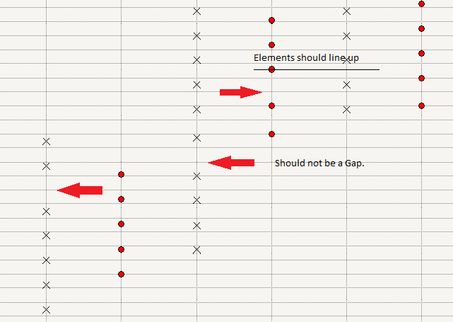

NOW down to business ... please refer to the below image.
Incorrect drawing of a point and figure.
PointFigure Bug.png (12.15 KiB) Viewed 5789 times
This looks like a bug ... in 1) alignment of the boxes (circles and X's) and 2) there are 'gaps' in the stacking.
If this is not actually a bug can you please tell me what settings would effect the Point and figure chart this way.

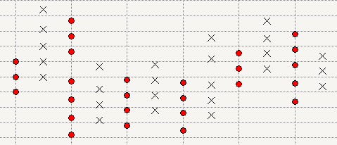

And just in case here's what Point and Figures traditionally look like ...

Cheers Phil.
P.S. Can't send an example application as TChart dies when I try and use design view something about the licenses.licx file.

Re: Point & Figure - can't populate the series ..
Post by Yeray » Fri Aug 13, 2010 7:03 pm
Hi Snarkle,
I'm trying to reproduce it with the following code but I can't. Could you please change it so we can reproduce it here?
Post by Snarkle » Mon Aug 16, 2010 12:32 am
Not enough data for a series P&F Try this ...

You'll see the graph render something like this.
Post by Yeray » Mon Aug 16, 2010 9:04 am
Hi Phil,
Thanks for the sample. Now I've reproduced it and added to the defect list to be fixed in future releases (TF02015088).
