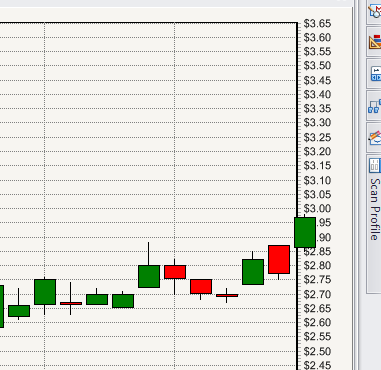

Side effect of proprtinal candles.
Post by Snarkle » Fri Aug 06, 2010 6:31 am
Greetings,
I implemented a variation of the preceeding code snippet ... simply marvelous ;-)
However I have an unexpected side effect where the Candles draw outside the Charts bounds and onto the Axis Label values ...
I remember seeing a property somewhere (I think) that stopped it drawing outside the chart bounds .. but I'll never find it again (no offense guys but the bundled documentation needs some work, some structuring and examples !!!.)
Candle drawing outside Chart bounds
I've attached a pic to show the side effect ... is there, as I have imagined, a property I need to set .... or do I use a workaround and somehow not plot the first and last candles that are visible on the Chart ?
regards Phil.

Re: Proportional Candles .. possible ???
Post by Sandra » Fri Aug 06, 2010 9:36 am
Hello Phil,
Could you please attach here a simple example code, where appears your problem, because we can find a good solution for you?
Post by Yeray » Fri Aug 06, 2010 9:41 am
Hi Phil,
I think you are looking for the demo at All Features\Welcome !\Axes\Opaque zones. Isn't it?
However, we can't reproduce it with the code that Sandra posted above. So it would probably be better if you could send us a simple example so we can investigate it.
Snarkle
Posts: 91
Joined: Wed Jun 30, 2010 12:00 am
Post by Snarkle » Mon Aug 09, 2010 1:40 am
Thanks Yeray,
I found this in that example ... tChart1.Aspect.ClipPoints=false;
I made it "true" and now the enlarged candles are suitably clipped ...
Cheers Phil.
