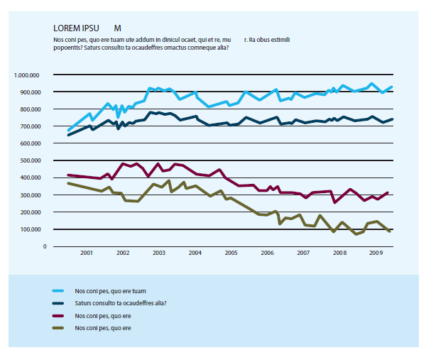

I have som problems customising teechart. I would like to end up with the first attached layout. Currently my main problems are:
[*]It doesn't seem possible to remove the border around the chart.[/*]
[*]No matter how I set the Height, Width, Rectangle, AutoSize, Size etc. properties on Chart.Legend I can't seem to control the size of the Legend.[/*]
[*]I would like not to use WebChart if possible.[/*]

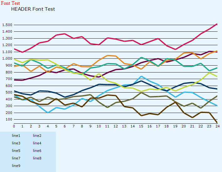

I was able to place and set the size of the legend, but now I don't seem to be able to place the series as in the reference chart in my original post (ResultStyle.png) with margins.
How would you prevent series to be cut off and let them continue in another column when the height is too small?
I also seem unable to set a different font at all anywhere.

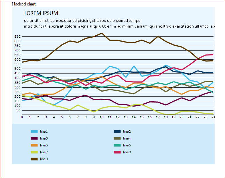

The problem with the border i hacked by creating a new image with smaller dimensions and drawing the generated image on that.
I have attached a solution with my current result as well as a picture.
If you should have any better way of creating this kind of chart when looking at my code I would be glad to know.

And what about setting the legend to be aligned to the bottom and change its width to clip it?
Chart.Legend.Alignment = LegendAlignments.Bottom;
Chart.Legend.Width = 180;
You can also control the columns witdth with Chart.Legend.ColumnWidthAuto and Chart.Legend.ColumnWidth instead of setting a big symbol width.

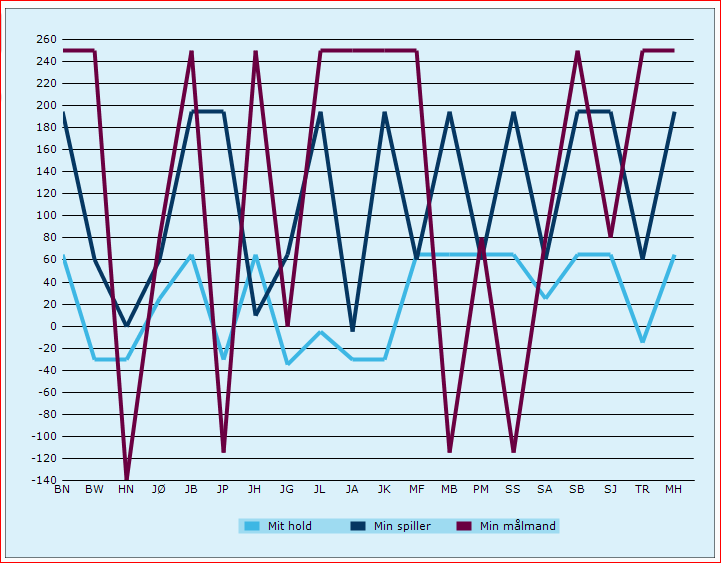

After some tweaking I have been able to get very close to what we want. The only important thing left is finding a way to style the symbols as in ResultStyle.png in my first post. That is with round edges and a smaller height. I don't seem able to do that. Is that right?
Secondly I would be glad to be without my hacks which involves creating a new image and doing drawImage and drawRectangle on it. You can look at it in my attached example (the web project). In order to achieve that I must be able to set the padding on the content in the legend which I could not find a way to do without my hack and likewise with the border that gets created when using Chart.Export.Image.PNG.Save().
But for now I can do with a solution to style the symbols.

Scanrate wrote:After some tweaking I have been able to get very close to what we want. The only important thing left is finding a way to style the symbols as in ResultStyle.png in my first post. That is with round edges and a smaller height. I don't seem able to do that. Is that right?
I'm afraid that the symbol hasn't these properties. What you could do is to draw it manually at OnDrawSymbol event doing something similar to the demo at All Features\Welcome !\Miscellaneous\Legend\OnDrawSymbol Event
Scanrate wrote:Secondly I would be glad to be without my hacks which involves creating a new image and doing drawImage and drawRectangle on it. You can look at it in my attached example (the web project). In order to achieve that I must be able to set the padding on the content in the legend which I could not find a way to do without my hack and likewise with the border that gets created when using Chart.Export.Image.PNG.Save().
You could try with BeforeDraw event:
        Chart.BeforeDraw += new Steema.TeeChart.PaintChartEventHandler(Chart_BeforeDraw);
        void Chart_BeforeDraw(object sender, Steema.TeeChart.Drawing.Graphics3D g)
            g.FillRectangle(Chart.Legend.Brush.DrawingBrush, 0, Chart.Legend.ShapeBounds.Y, Chart.Legend.Width, Chart.Legend.Height);
