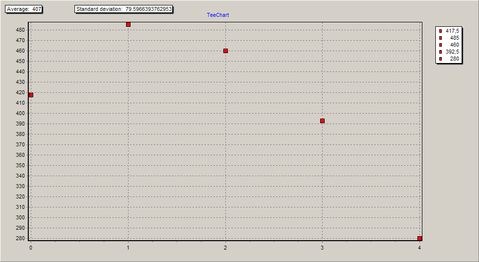

Post by Yeray » Tue Jul 27, 2010 8:56 am
Hi Hari,
The example above gives me the following result:
Doesn't it give the same result to you? What exact TeeChart version are you using? Is it the latest available in the client area?
