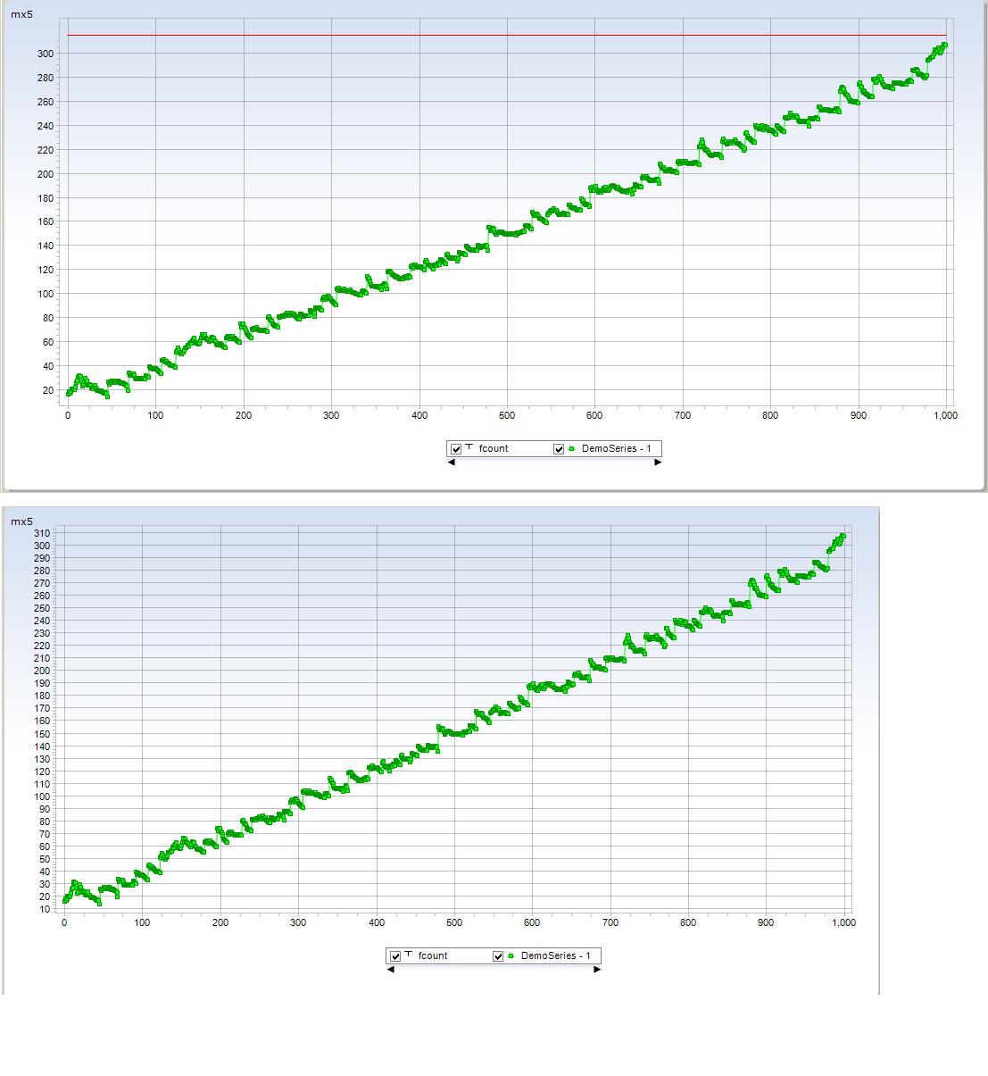

1. There is a problem in Error Bar Series Visible.
Red Series is ErrorBar.
At Chart Resize Width Change, ErrorBar Series not visible.

Hi BISTEL,
I'm trying to reproduce the problem with the following simple example project, but I can't:

Could you please check if you can reproduce it in your machine and, if not, could you please modify it so we can reproduce the problem here?
