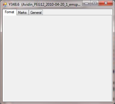

I want to show the editor for one series by this code:
    Public Sub EditActiveSeries(ByVal Series As Series)
        Dim ed As New Editors.SeriesEditor
        ed.series = Series
        ed.Text = Series.Title
        ed.ShowDialog()
    End Sub
Unfortunately, the format page is empty:
Other tab pages seem to work.
I figured out that this code works:
        Dim ParentEditor As New ParentEditor 'it's an empty form
        Dim ed As New Editors.SeriesEditor(Series, ParentEditor)
        ParentEditor.Text = Series.Title
        ParentEditor.ShowDialog()
    End Sub
But why does the first code not work?

Post by Sandra » Fri Jul 16, 2010 11:37 am
Hello Uli,
I could reproduce it and I think that is a bug. I have added it in bug report list with [TF02015034]. We will try to fix it for next maintenances releases of TeeChart .Net.
