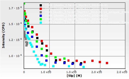

Changed behavior in legend
Post by Uli » Mon Jun 21, 2010 12:30 pm
due to the last discovered problem http://www.teechart.net/support/viewtop ... =4&t=11243 concerning wrong axis scaling I immediately checked the new release (Build 4.0.2010.27963, it was published a few minutes after that posting).
This earlier posting is related to a strange axis scaling and therefore I will not add the new problem to this thread. But there you can see how the legend appears with the old release http://www.teechart.net/support/viewtop ... =4&t=11243
When I now open the same *.ten file (it's contained in the *.zip of the above URL) in my application compiled with the newest release it looks so:
The black legend items text disappeared (the white text is due to another bug explained below)
The reason is:
In order to get sub- and superscripts I go the following way:
- creating custom rich text for legend items
- setting the "regular" legend font to color.transparent but the same size as in my "custom" rich text
- drawing the "custom" legend items in a function called from within the TChart.AfterDraw event using "regular" items properties:
        X = MyChart.Legend.Items(series).Left
        Y = MyChart.Legend.Items(series).Top
And here is the error now: Both X and Y are zero in the application compiled with the new TeeChart release.
You can easiliy check it out:
    Dim lineser As Steema.TeeChart.Styles.Line
    Dim lineser2 As Steema.TeeChart.Styles.Line
    Private Sub Form1_Load(ByVal sender As Object, ByVal e As System.EventArgs) Handles Me.Load
        lineser = New Steema.TeeChart.Styles.Line(TChart1.Chart)
        lineser.FillSampleValues()
        lineser2 = New Steema.TeeChart.Styles.Line(TChart1.Chart)
        lineser2.FillSampleValues()
    End Sub
    Private Sub Button1_Click(ByVal sender As System.Object, ByVal e As System.EventArgs) Handles Button1.Click
        TChart1.Legend.CustomPosition = True
        TChart1.Legend.Color = Color.Transparent
        TChart1.Legend.Font.Color = Color.Transparent
        TChart1.Export.Image.Metafile.CopyToClipboard()
        Dim x As String = TChart1.Legend.Items(0).Left.ToString
        MsgBox(x)
    End Sub
    Private Sub TChart1_AfterDraw(ByVal sender As System.Object, ByVal g As Steema.TeeChart.Drawing.Graphics3D) Handles TChart1.AfterDraw
        MsgBox(x)
    End Sub

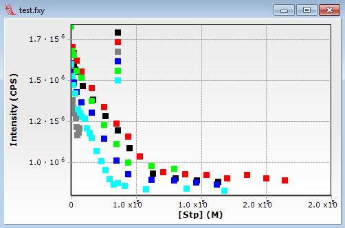

And another bug becomes visible (the code in Button1_Click is to follow this): The image above was exported as metafile to clipboard:
ActChildForm.Chart1.Export.Image.Metafile.CopyToClipboard()
and then pasted into MS paint.
You can easily see that the "regular" legends font color (which was set to transparent) is not transparent ***.
This error occurs during metafile export since a screen copy (by means of Windows 7 snipping tool) results in this image:
Here the "regular" legend font seems to be really transparent.
Please note: The file extension ".fxy" I use in tradition of the old application which shall be replaced by the new one with TeeChart. But the *.fxy files are native *.ten files with no attempts of extending serialization.
What to do?
I could reproduce it and I have added in bug report list with number [TF02014990]. We will try to fix it with next versions of TeeChart .Net.

Uli wrote: When I now open the same *.ten file (it's contained in the *.zip of the above URL) in my application compiled with the newest release it looks so:

Uli wrote:When I now open the same *.ten file (it's contained in the *.zip of the above URL) in my application compiled with the newest release it looks so:
Try:
tChart1.Legend.Font.Color = Color.Black;
That is a misunderstanding, please see my first post: The "black legend items text" is my "custom item text" (a rich text format string) which should be drawn instead of the "regular TeeChart items" in the AfterDraw events. The white text is that of the regular items for which the legend font was set to color.transparent. It's explained above in more detail. So with your proposal only the "regular items" would become visible - the opposite of my intention.
Again: What to do?

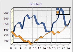

With respect to the other issue ("regular item text" visible after copying to clipboard): I tried it out now. Unfortunately, Christophers suggestion
TChart1.Export.Image.PNG.CopyToClipboard()
leads only to an empty chart (no data series) in Word or Paint.
I try again code that suggest Christopher and here seems that works fine with last version of TeeChart.Net and using next code:
  private Steema.TeeChart.Styles.Line lineser, lineser2;
            lineser = new Steema.TeeChart.Styles.Line(tChart1.Chart);
            lineser.FillSampleValues();
            lineser2 = new Steema.TeeChart.Styles.Line(tChart1.Chart);
            lineser2.FillSampleValues();
            tChart1.Legend.CustomPosition = true;
            tChart1.Legend.Color = Color.Transparent;
            tChart1.Legend.Font.Color = Color.Transparent;
            tChart1.Graphics3D.BufferStyle = Steema.TeeChart.Drawing.BufferStyle.OptimizedBuffer;
            tChart1.Export.Image.PNG.CopyToClipboard();
I get next image .png with chart full:

Hi Sandra,
I tried the code of Christopher with a minimal sample application again. Now it works. I just realized that the first attempt I carried out with my current code under work and I forgot to comment out a following line which copied another empty chart... Sorry! Obviously I was a little bit confused since I tried some other things, too.
I assume this as a workaround with which I can live up to the next maintenance release. But you are still asked to make possible a correct metafile copy via clipboard since the png copy looks not so good when changing the size.
