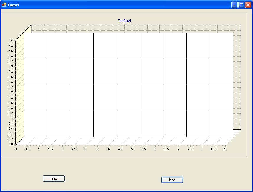

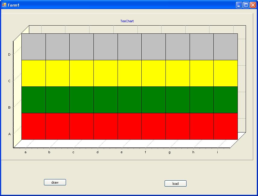

The following two pictures are what is when i press button 1 (draw and save .ten file) and button2 (load .ten file)

The picture for load the .ten file.

Post by Sandra » Fri May 07, 2010 10:56 am
Hello Hookem,
I have tested your project, and in version 4 of TeeChart.Net works fine. But we have found a problem with export and I have added it in bug report list with number [TF02014851]. We will try to fix it for next maintenance release of TeeChart .Net
