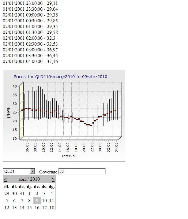

I have tested your project, and here it works correctly using last version 4, Please see next image:
On the other hand, I have changed your code, because you could see all DateTime. Please, add in your code next lines and check if it works correctly for you.

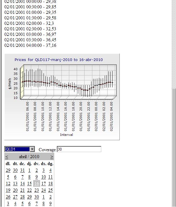

   webChart.Chart.Axes.Bottom.Labels.DateTimeFormat = "dd/MM/yyyy HH.mm";
         webChart.Chart.Axes.Bottom.Increment = Steema.TeeChart.Utils.GetDateTimeStep(Steema.TeeChart.DateTimeSteps.ThirtyMinutes);
Using previous lines we get next results:
If still, you couldn't solve the problem or code doesn’t work as you want, could you say us exactly, what is your problem, because we can try to help you?
