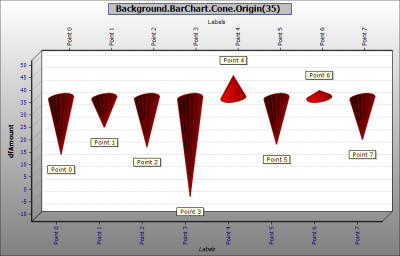

What I have noticed after playing with 2009 version - the bars are drawn under slightly different angle now. Here are two identical graphs:
This one created using version 3:
And this one - using version 2009:
Ideally, I'd like them to be the same (besides the bug fixes!)

Hello UserLs,
Bars are drawn under slightly different angle now, for consistency with other TeeChart versions. If you want to have same result in two graphics you only change value DephtPercent as next:
 Steema.TeeChart.Styles.Bar bar1;
            bar1 = new Steema.TeeChart.Styles.Bar(tChart1.Chart);
            for (int i = 0; i < 10; i++)
                bar1.Add(i, i + 5);
            bar1.Marks.Visible = false;
            bar1.BarStyle = Steema.TeeChart.Styles.BarStyles.Cone;
            bar1.UseOrigin = true;
            bar1.Origin = 10;
            bar1.DepthPercent = 50;
