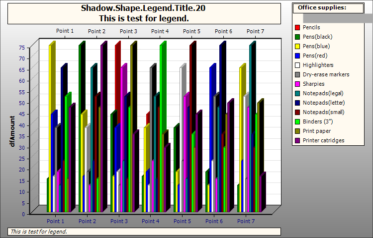

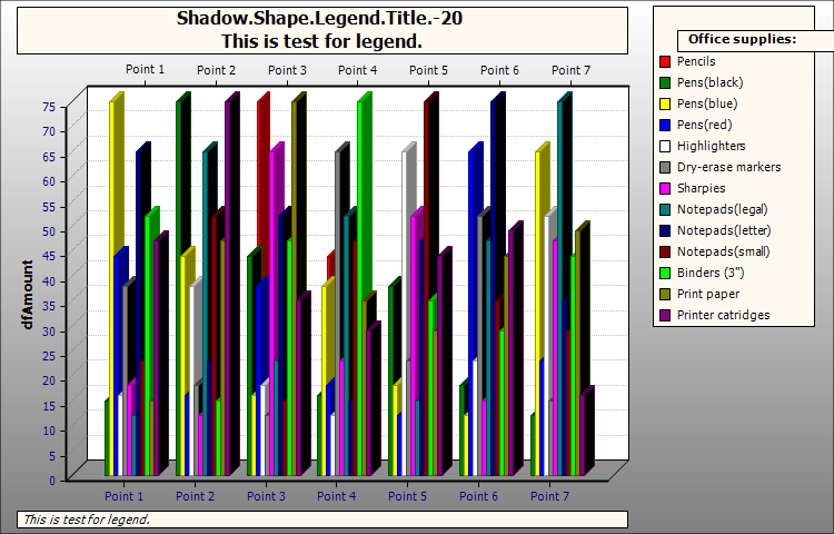

Here I've set legeng title shadow offsets to (-20, -20) so the problem is more visible:
You cannot see the shadow and the title is running out of the legend box.
If I am using offsets (20, 20) - the shadow now is outside the legend box:

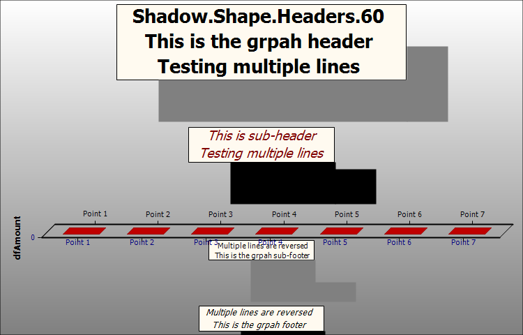

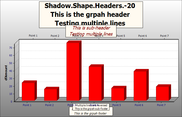

For the headers as you can see shadow with negative offsets (-20, -20) do not show up, but the graph is trying to recalc positions to accommodate the shadow. As I suspect, the problem here - offsets are treated as positive numbers and threrefore parts of graph are running onto each other.
The next image is using positive, but big offsets, just to show, that shadows still have major probles (ironically, a lot better behavior is demonstrated by shapes with round rectangle!)
