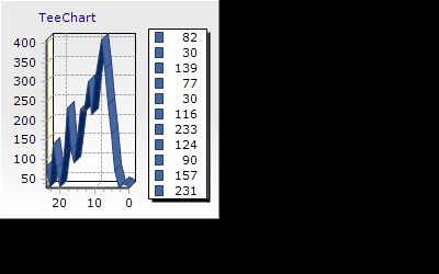

I see that CustomChartRect is not working as expected. I've added the issue (TF02014734) to the list to be investigated for future releases.
Using TeeChart for .NET 2009 I get this:

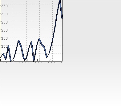

While using TeeChart Pro 2010 VCL beta I get this:
Which is what I'd expect from CustomChartRect.
